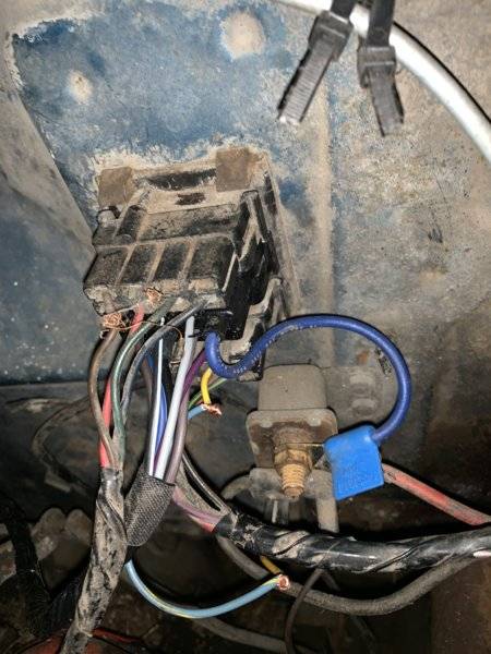

I have the eingen harness and the wiper harness I need to know what the harness on the bottom is and where to find it. 1969 coronet 440 318. Any help is appreciated!
$160US from Year One
https://www.yearone.com/Product/chrysler-b-body/hu223b#prettyPhoto
When I get out to the shop I'll dig out my OE harness, that I removed from my car, and see if I think I want to sell it and determine a value if so for you.... if you don't want to go new reproduction. Do you have fender mounted turn signals?
if you buy from YO make sure its in stock or you might be waiting 6 weeks for it.
Okay, I had got my old one out and got pictures in case you wanted used. The new one from YearOne will be an M&H harness and it will come with the fender mount turn signal indicator wires already on it spliced off the bumper signals. I just taped them off for my car as it didn't have the fender mounts, but if yours does the connector/wire is there to just plug in!

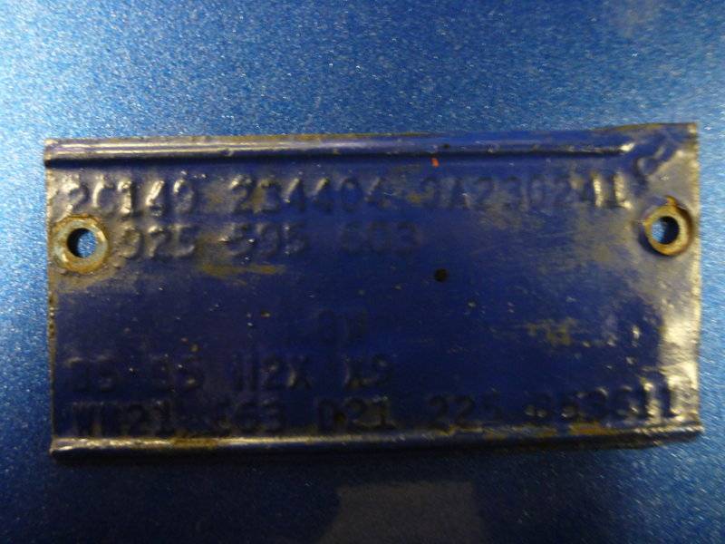

As for manufacture date... do you have a fender tag? If so it's on there and is a "suggestion" as to the true date it came off the line. My car was "built" Feb 25th, yet the motor wasn't built until the 27th and drivers exhaust manifold was cast on the 28th.
Bottom row of numbers... the 225 = Feb 25th.
