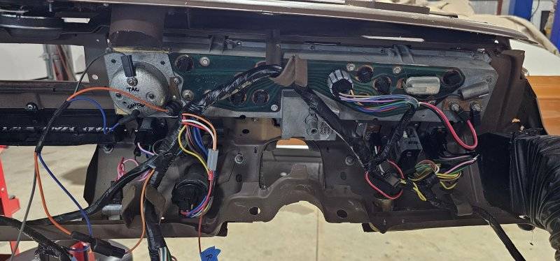

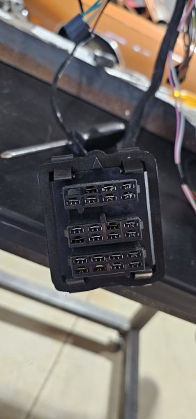

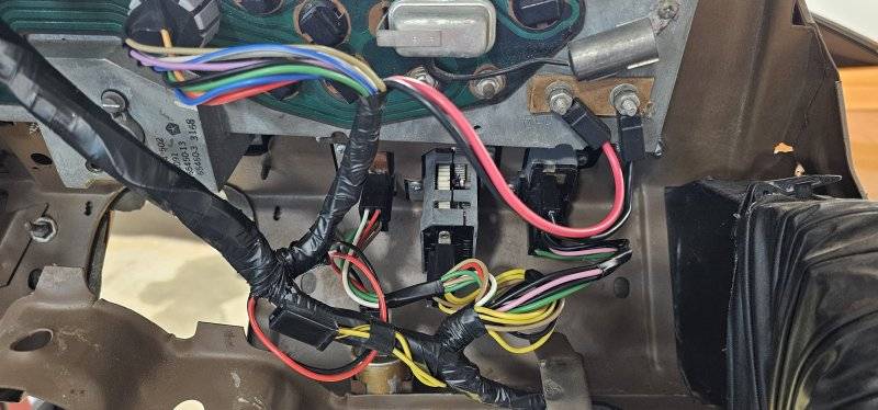

I am restoring a 1969 GTX, auto and AC. Currently restoring and wiring up my dash. I am using a new M&H dash harness for my heat and AC optioned car. I have read through many of the threads on the issue with overheating the firewall connection point with the positive wire fed through the connectors. Honestly, there is a little overload on hiw many opinions and recommendations are out there. So would like a little more help to make sure I do it right.
Question: Does the new M&H harness address thus issue, or is it factory stock and will have same overheating risk?? Second question: if I need to modify my setup, which of the many recommended fixes should I follow?? Not opposed to swapping the gauge from Alt to Amp, just want to do best option to avoid future issues.
Pics below of where I am currently.

So the M&H harness does not resolve the problem. That's what I figured. Did you drill out the one connector to run a solid wire from point to point?
The M&H harness is a duplicate of the original, so no change in wiring paths. I chose a M&H harness with a parallel path from Alt to Ammeter using an extra hole someone drilled on my firewall. I have an AC car and find i need to run my fan on Medium instead of the default low speed to keep the heat down on the blower resistor and wiring.

So let me see if I have this right. No change to factory gauge or current M&H harness. Run a new red wire from alternator, through firewall, to the "Pos" terminal lug on back of gauge panel. What do I do with existing Red wire from the harness that connects currently on the "Pos" lug?
Do a search on this forum and Youtube on ammeter bypass.
A member here has posted some good videos and explanations on what/how to by-pass.
ALL GOOD!!! A couple of you pointed me to a few videos on the subject and it all makes sense now!! Thank for pointing me in the right direction! As much as I searched for answers, don’t know how I missed these videos.
