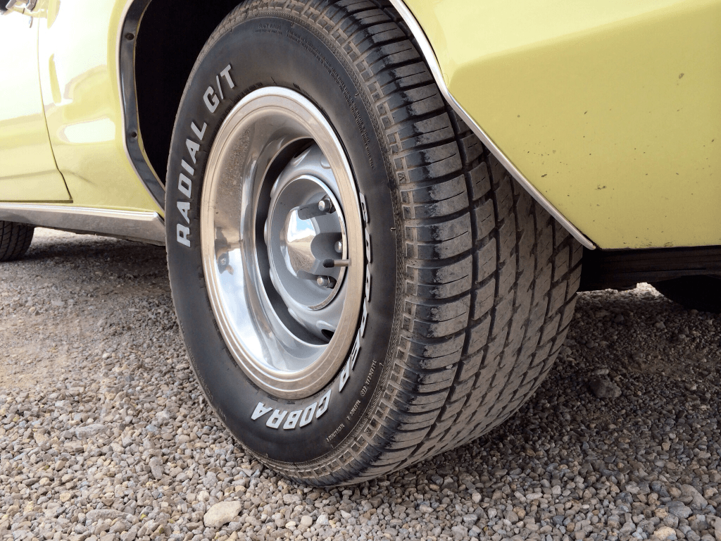

69 Coronet. 225-70 14 front. 295-50 15 rear 8 inch rim.
so how does the 295 55`s work on an 8" rim I have 295 65 15`s on 8 '' and their really just a bit narrow, would at least like to have 8 1/2" wide, but don`t think I can get a 9" to clear. Are u running them a little low on pressure? Am running about 21 lbs in mine. (drag radials)
Street. 28 lbs. Left rear kisses inside leaf when pushed very hard. Putting a spacer in. 8" rim gives the look I like.
