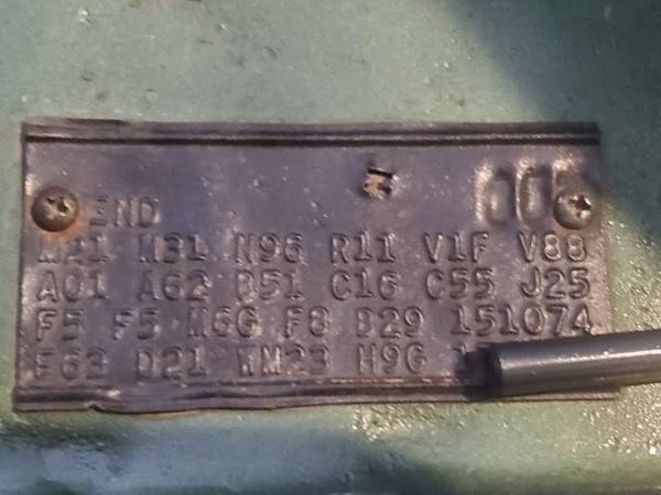

I am looking to see if anyone can help decode my fender tag?
Starting at the bottom left...
E63 383 CID HP 335HP
D21 4 Speed Manual Trans
W Coronet/Charger
M Medium Price Class, Superbee
23 2 Door Hardtop
H 383 335HP
G St Louis, MO Assembly Plant
Remainder of this row is the sequence number
E63: 383 cid 4 barrel V8 High Performance
D21: 4 Speed Manual Transmission
F5: Medium Green Metallic Exterior Color
F5: Trim - Luxury, Cloth/Vinyl Bucket Seats, Green
M6G: Unknown Int. Door Frames
B29: Build Date: November 29
151074: Order number
A01: Light Package
A62: Rallye Instrument Cluster Package
B51: Power Brakes
C16: Console w/Woodgrain Panel
C55: Bucket Seats
J25: 3 Speed Wipers (required with N96)
M21: Roof drip rail moldings
M31: Belt Moldings
N96: Fresh Air Hood
R11: AM Radio
V1F: Full Vinyl Top, Green
V88: Transverse Stripe Delete
END: End of Sales Codes

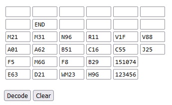

There's just a bit of a glitch in that decoder's layout - Line-2: At 5 data fields, the "roof color" is the one that doesn't exist. 6 fields in that line would be better for '69 St. Louis. "F8" is Green upper door frames.
F5: Medium Green Metallic (Dodge), Limelight Metallic (Plymouth), Avocado Metallic (Chrysler) Exterior Color
M6G: Trim - Opt. Decor Group, Vinyl Bucket Seats, Green
F8: Dark Green Metallic (Dodge), Ivy Green Metallic (Plymouth), Jade Green Metallic (Chrysler & Imperial) Int. Door Frames
There really should only be 5 fields in line-5, too.
