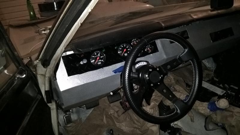

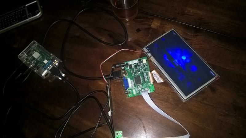

I have decided to go a different way with the dash. I have built a touch screen media system with raspberry pi. I will be also writing some code the automate a few other things with the car.

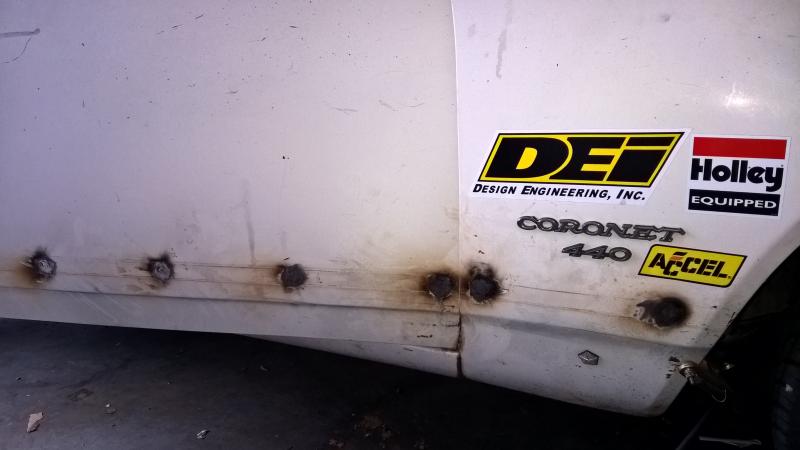

I picked up a small tig welder and trying to learn it. I have started plugging the trim holes .
The dash is just a mockup to get the measurements for now.

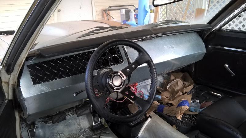

I finished my dash and my touchscreen setup for the most part. I still got to mount it and decide how i want to mount my usb extension for the pc. I created a local proxy so the pc will pull network connectivity off my phone.
I created a second console area in front of my gearshift that has the ignition, wiper, washer, flash, switches.

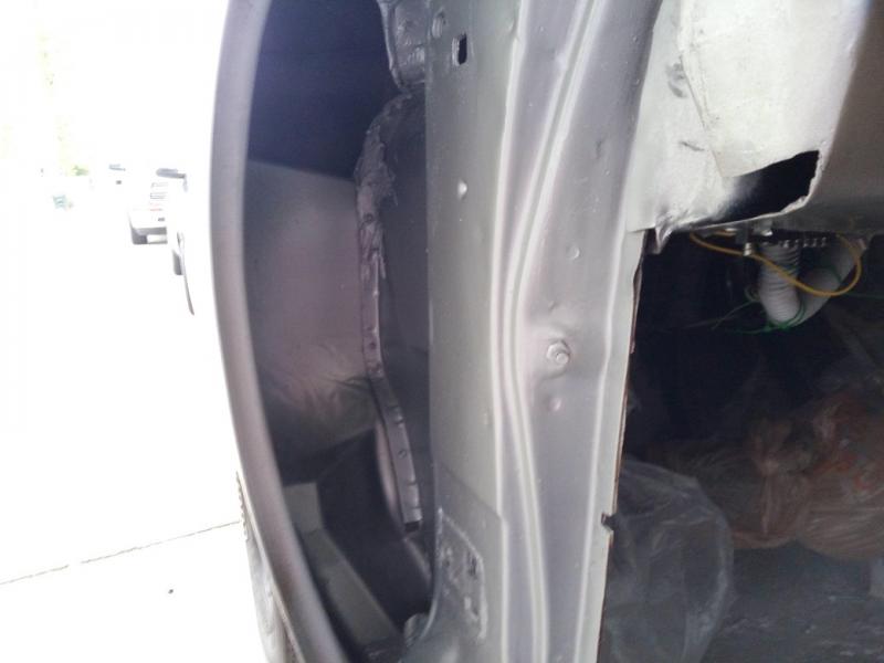

I have also pulled out my rear lights and panel to fix a few rust areas. Testing out my new tig welder.
I am getting back to it after my back surgery. So far I have felt a lot better getting around. Just taking it slow and careful.

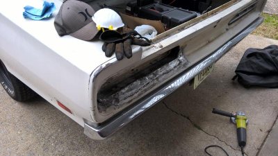

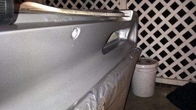

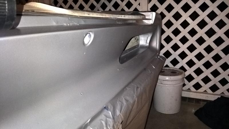

I cut out some of the tail panel around the tail light that had rust issues. I was able to tig weld a few panels in.WP_20160220_13_50_05_Pro.jpg

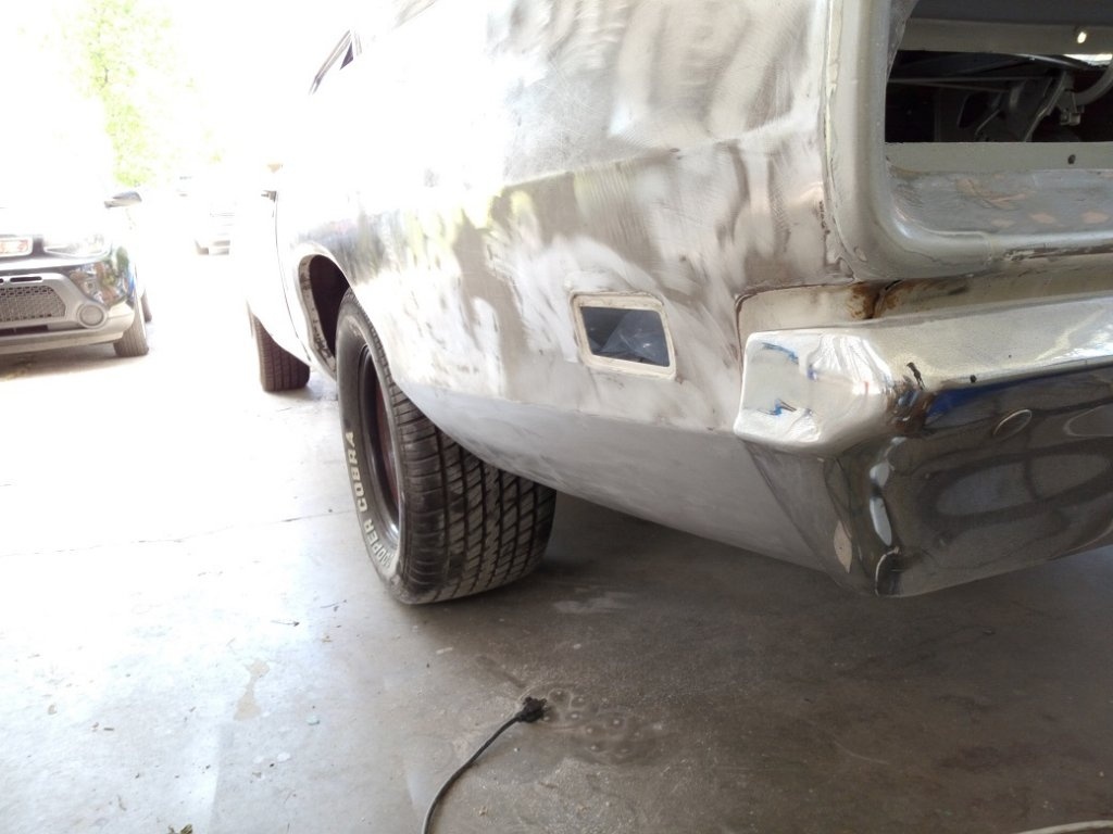

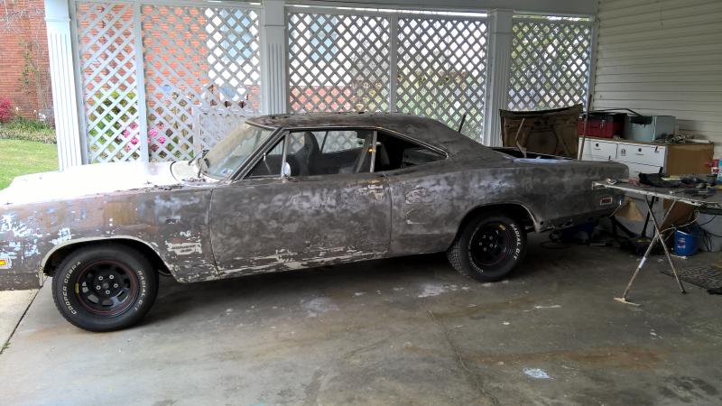

I also started stripping some of the paint on the rear of the car as I go. I just wanted to mention that I was using citrisstrip gel. Maybe people have used this before but after putting in on the car for about 15 minutes I was able to start removing paint with a razor. I have no clue why this picture has flipped upside down.

I am very surprised on the shape of the metal under the paint. I was worried on a few places but it was all original paint and no bondo spots.

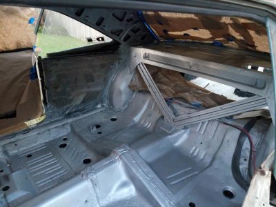

I have pulled out the interior and the old ratty headliner. Tried to sand down and remove all the insulation I could.
scuffed up the interior and started coating the inside, roof, and package tray with Rust Bullet. I am trying to spray this in and really like it so far.

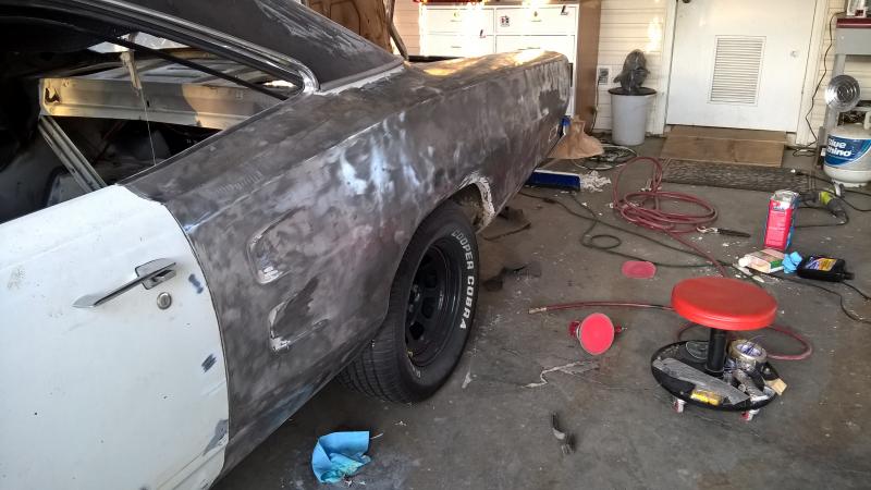

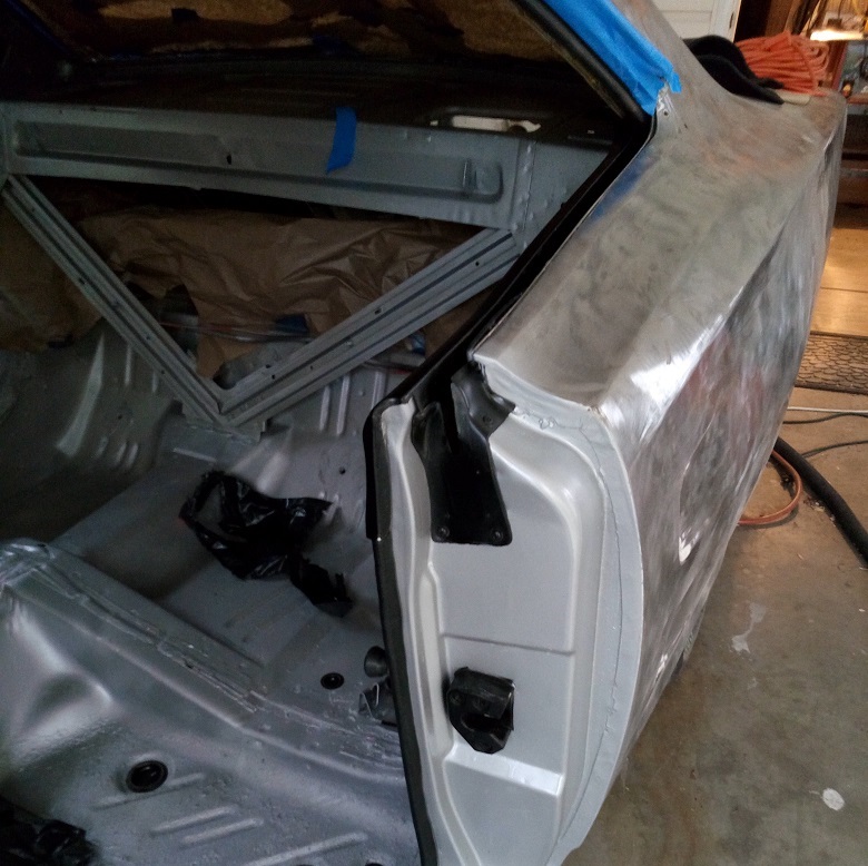

Was able to get the rear quarter panels situated. They will need a skim coat to smooth out more.

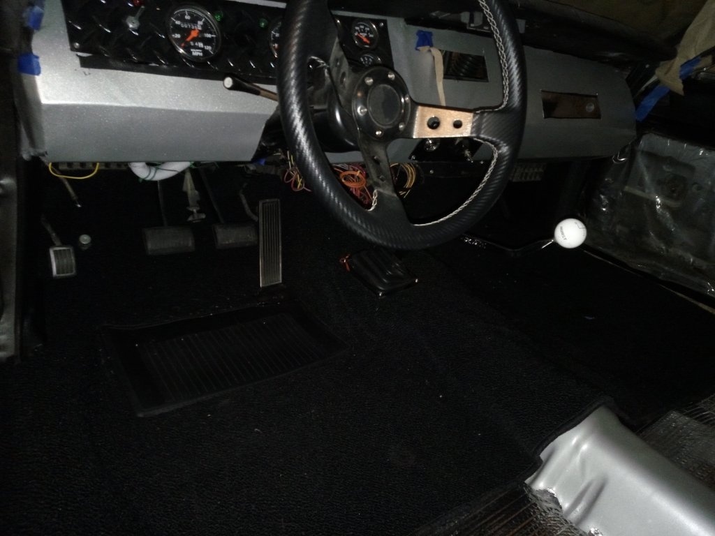

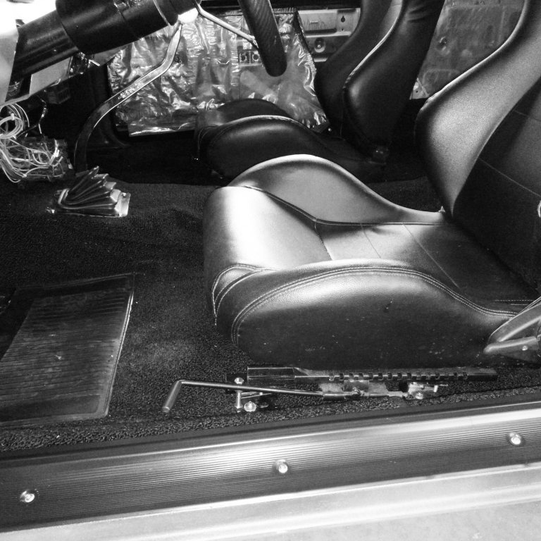

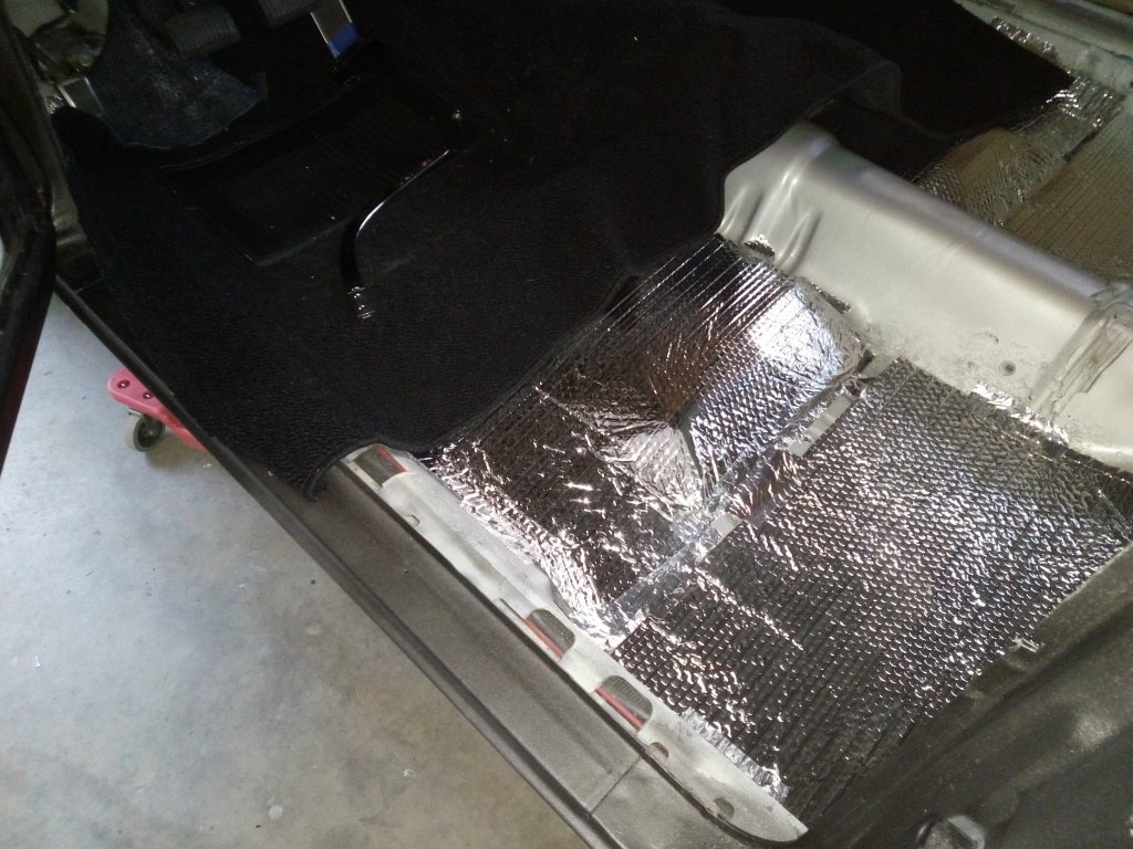

Got the carpet pretty much installed and front seats put in.

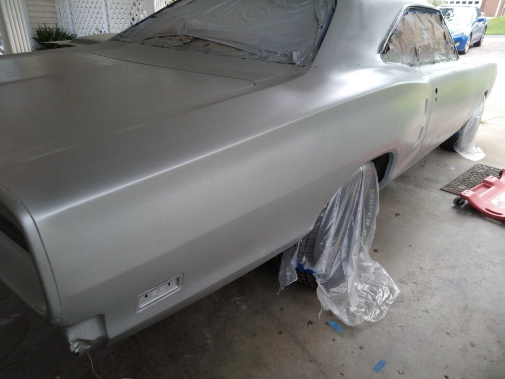

The car has been coated with rustbullet. Next step will be to review all the panels making sure they are correct and flat. Then on to primer the car.
