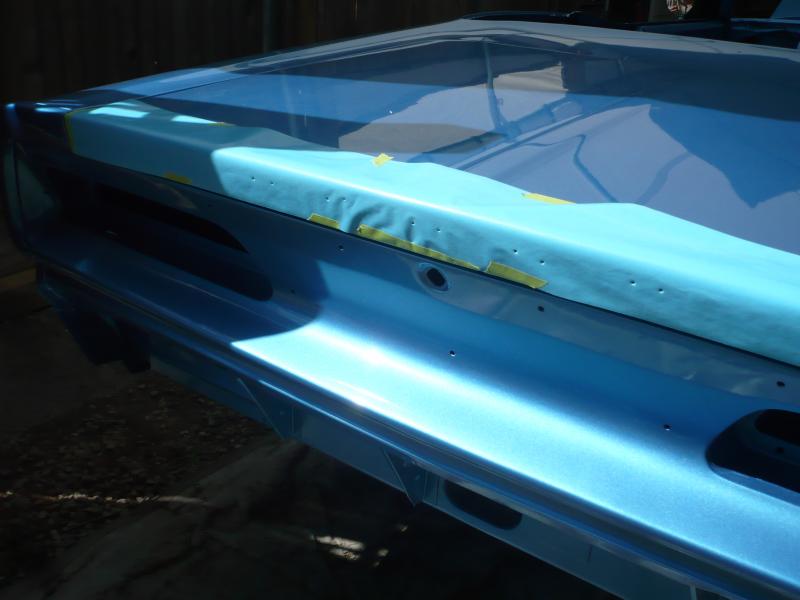

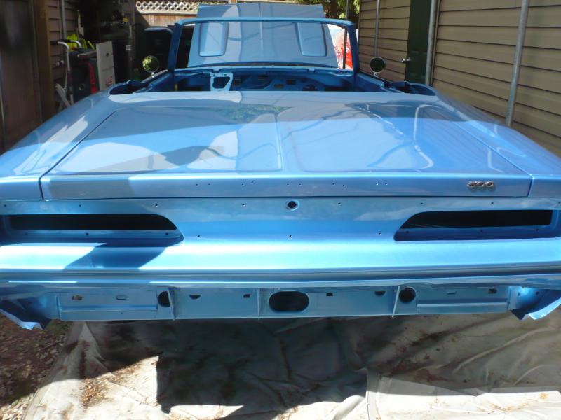

I have not installed my letters yet . Do to the fact i dont have a set of letters. I can make a template and send you the template. Will this work for you. I will mark the starting points. sassy 71 008.jpgtemplate 006.jpg
