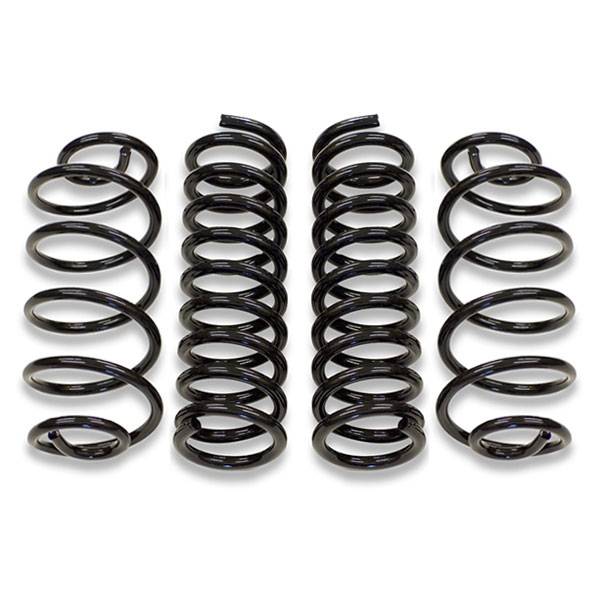

Well i was talking about this stuff
lift-springs-coil-taller-extended-71-76-b-body-caprice-impala-88-lesabre-heavy-duty-lifted.jpg
My fault.
Never had a Mopar bevor, the Charger will be my first. ^^
My 71 Cutlass has Coils. :D
Just in case you don't know, Mopars use Torsion bars instead of coil springs. To your question, the difference in torsion bar diameter (aka size or thickness) is based on the engine the car was built with. So in your situation, the 318 car would have thinner (smaller) torsion bars than an RT with a 440, the good news is that you can (and probably should) replace them with the correct or even bigger size (the thicker they are, the stiffer the front end becomes and in general the better they handle up to a point as there are some very thick bars which will give you great handling but a very harsh ride).

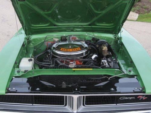

Just looked at pictures from Sold Hemi Cars.
Look at the Thing in front of the Radiator (right side)
Looks like an Oil Cooler, right?
Have now seen 4 Hemi Chargers with that in total.
That at least leads me to think that it was Standard Equipment on Hemi Cars.
Or is that something different?
Yes.

That cooler on the radiator is a transmission oil cooler.
