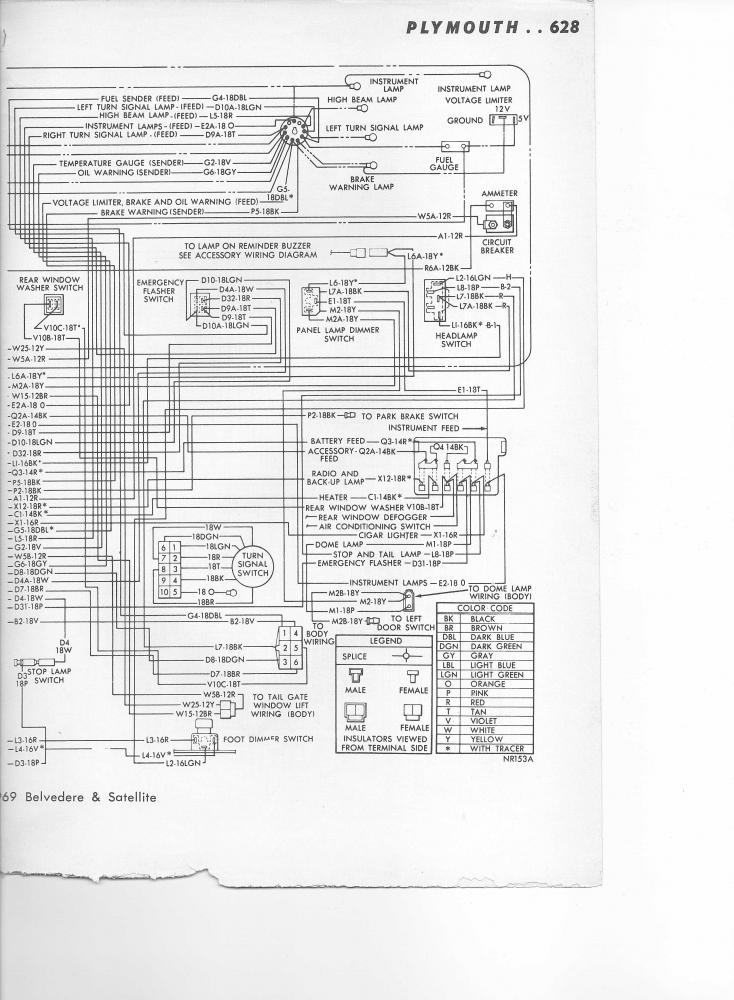

If I have a 69 GTX dash circuit board that has broken prongs, does that effect the dash lights and dash temp gauge?, of which are not working.
Thanks
If you have access to a Service Manual and go to the wiring diagrams section you will be able to figure out which circuit is affected by the missing prongs. Good luck, Al
This is a 1969 Belvedere & Satellite example which matches my 1969 Coronet diagram so I am assuming they are all pretty close to the same.
To answer your question, yes.....broken prongs will effect them.
The prongs can be soldered back on. Just takes a steady hand. Or, you can buy a new circuit board.
