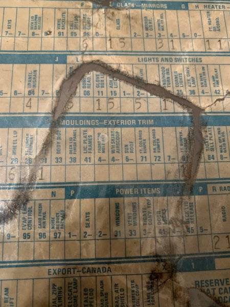

my 70 GTX has the rally dash but is not woodgrain. door panells are tho. Vin on dash, fender tag, door sticker, and engine block all have the same no. were some sent out with the black dash? my research says all dashs on those cars were woodgrain. vin no. starts off RS. and fender tag i coded out matches what is on the car, kind of curious.

I believe it was an option, my 70 GTX build sheet shows it marked with a “4” in group J
