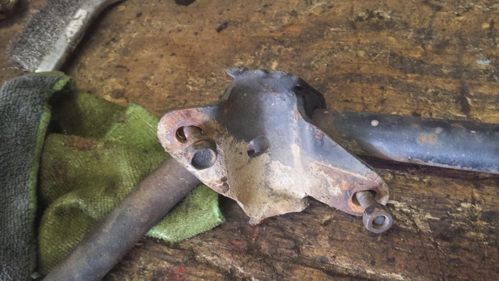

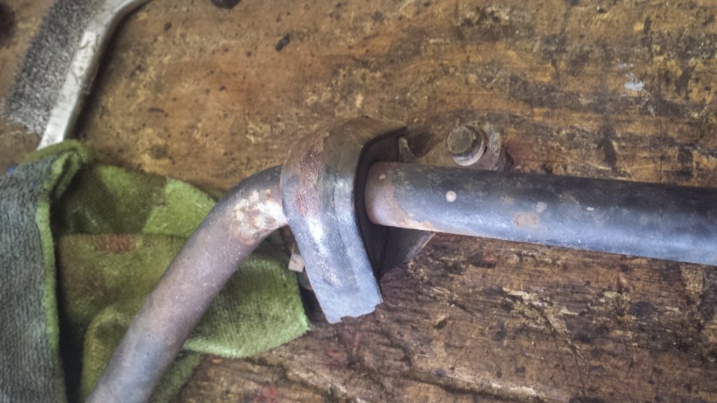

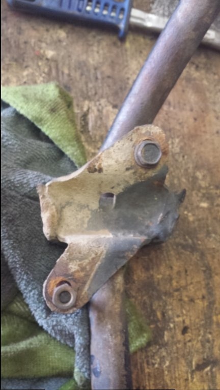

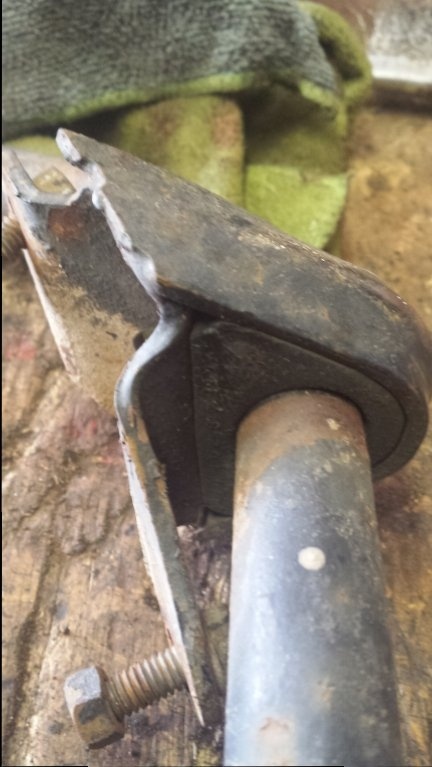

Hmmm. How do I replace these bushings? The two mounts are welded solid, no way to get the old out without cutting or tearing. Also, the replacement bushings I received from PST are round whereas these are triangular. I could cut one of the welds to r & r and reweld but the bushings are different.
Are these stock? Are they modified stock? They fit like factory as far as I can tell.
Cut the weld at one end of the strap, bend it back enough to remove the old bushing, install the new bushing, reweld it together.
That's the general way that most folks do that job.
You got the wrong bushings.
Energy Suspension, is a good source.
Your original bushings look ok to me.
Ya know, i thought the same thing when i looked at the pictures.
But i kept my mouth shut, and fingers off the keyboard, thinking if the op wants to change the bushings, that's his business, why he's asking how it's done.
If they look ok I will leave them, less work for me. I will need to contact PST to exchange these out since they came with the kit I bought and save them for the future. Thanks for the help!

View attachment 362765 View attachment 362766 View attachment 362767 View attachment 362768
