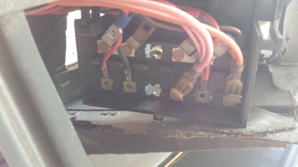

I just need to see where a cluster of pink wires goes on my fuse block. It was unattached when I tore my dash down and would like to get the wiring squared away. Could someone post a pic of theirs from the back?
Here is what I have...Pink circle shows the floating cluster.
Probably the second terminal with the rest of the pink ones. Look at a wiring diagram and trace some circuits back, that will tell you exactly where they go. MyMopar.com has service manuals you can download.
