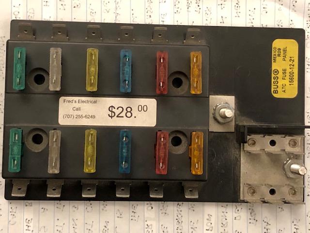

Guys, I need to connect a few spade connectors to the back of my fuse block for a tach and voltmeter to come on when key is "on", but not to "start". I tried searching for the relevant blue IGN 1 wire under the dash but the wire schematic diagram has me confused and I couldn't find a wire I could be certain about to splice into. I'd rather just spade it into the fuse block. I see a few open male spades here, where should I connect my tach/voltmeter? Thanks!
I had a minor meltdown then replaced my fuse panel with one that had one additional fuse in it. From 6 to 7 fuses.
I later added an additional fuse panel that is powered through the starter relay with a relay in between.
