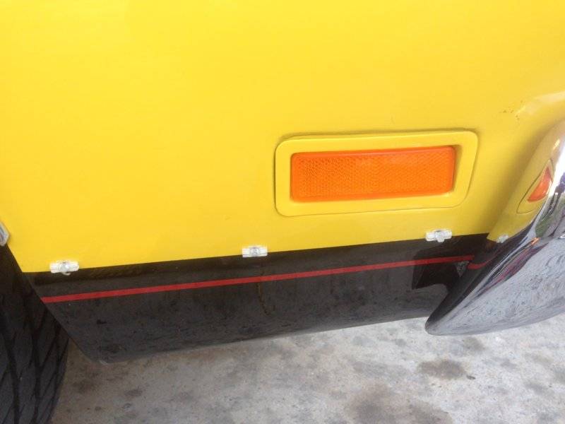

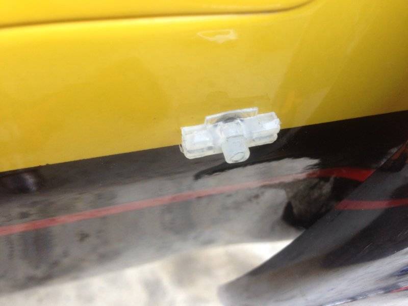

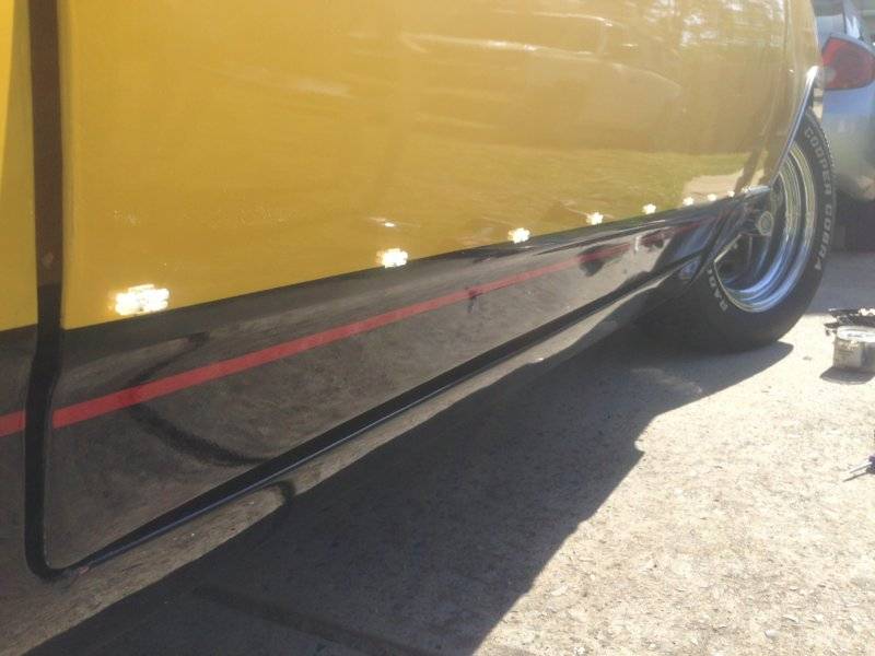

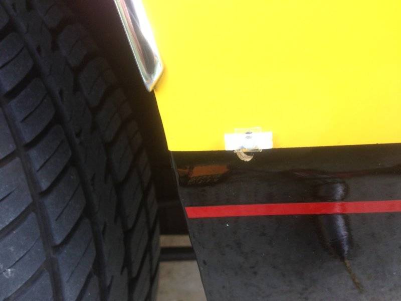

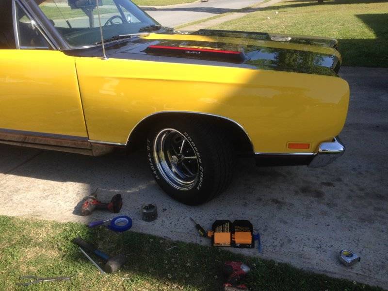

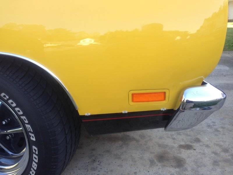

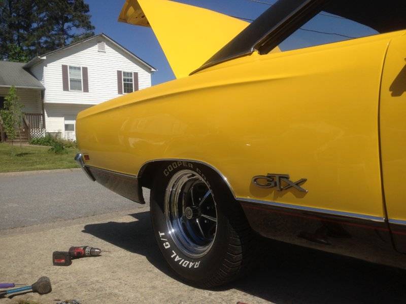

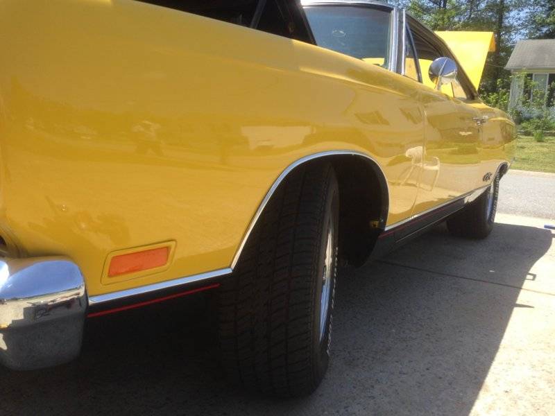

OK I know there was another topic on this. However I couldn't find any instructions or pictures of the installation method for the lower side chrome. With the exception of the 8 speed nut type fasteners which should be used in the trunk area since this is the only logical place to put them. The rest are the little plastic kind with the plastic pin. Use a 3/16 drill bit and get a rubber hammer. Someone said to use the speed nut type by driving the speed nut into a 1/4 inch hole.. That is incorrect. The only place you put those speed nut fasteners is in the trunk area.
Fastener locations.

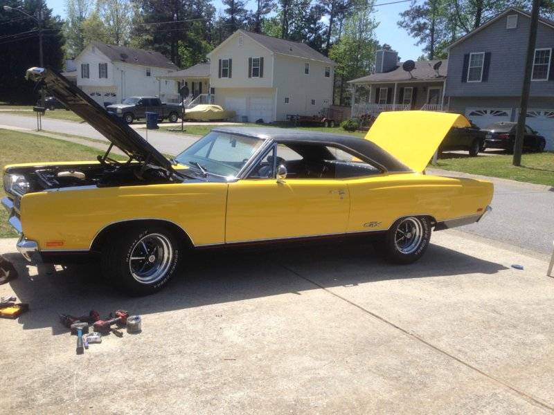

This is my friends car. In the last picture in the background you can see the Roadrunner under a car cover.. Should get them together one day and take a Ketchup and Mustard Picture. I posted these pictures because pictures are worth a 1000 words. And should save some time for anyone guessing. I did not use the 8 speed nut type in the trunk area. However may still do that. But thats where they go.

The speed nut also goes on the last hole to the rear of each door.....
