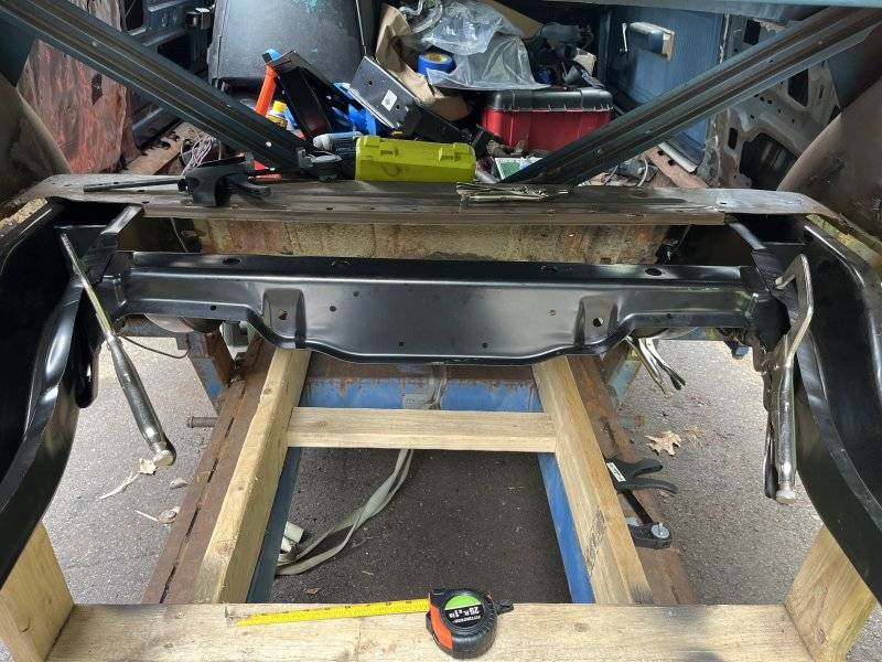

1969 gtx , upper rear shock support bracket . Nothing on car I bought . Do they get bolted on . Shows nothing in service manual.
They are welded in, AMD makes them.
Thanks . What a shame , under car is already done and the guy who did it dident put one in before paint
If you're really carefull, you can drill some 1/4" holes in the panel where the spot welds are
and mig them in without too much heat damage to the surrounding paint. Prime and paint
the support before you weld it in. You'll have a minimum of touch-up later. Good luck!

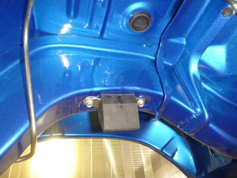

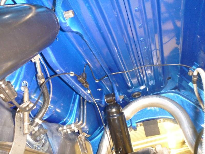

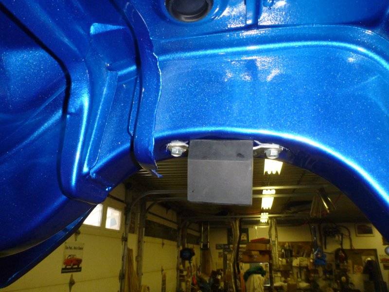

All I have is a wire welder , think that would work ?
Yes! as Dadsbee illustrated with the Excellent pictures, you can mig that baby right in!

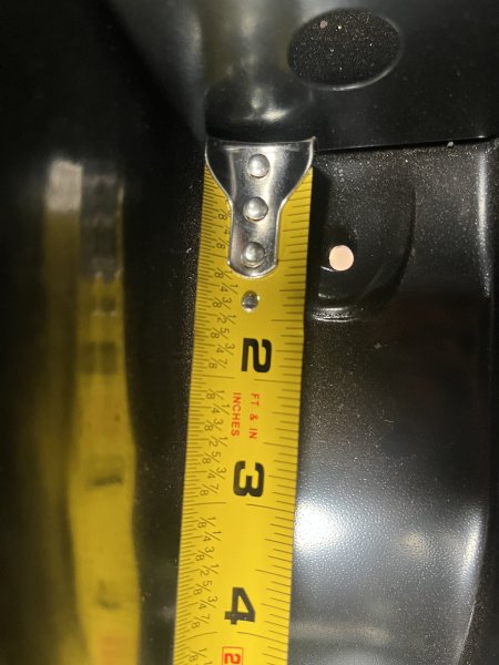

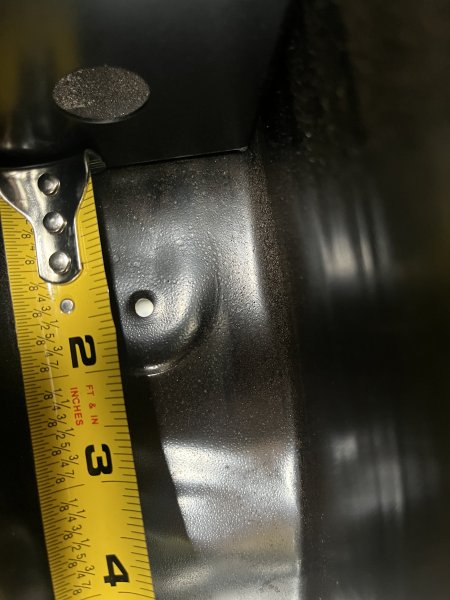

Not sure why your bump stop holes are different, they should be identical side to side. The shock attach bulkhead and it's different length tabs will only sit properly in one location.
These are the bump stop holes relative to the middle reinforcement, and the tabs are also in different places and are different sized on the frame rails for where the braces should line up
As long as the brace is close to square and level around the area of the tabs it should clear the floor and be good enough ?
The floor is a little crooked but this is where I’m at
