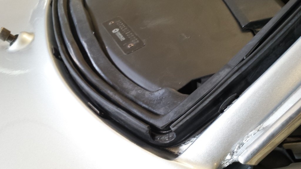

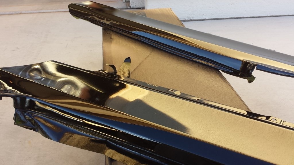

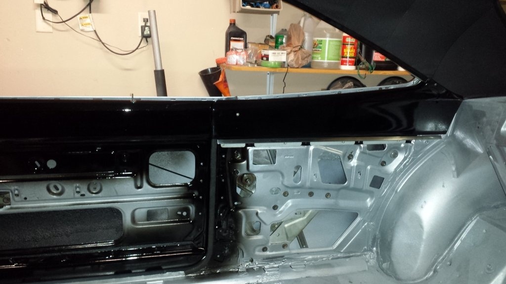

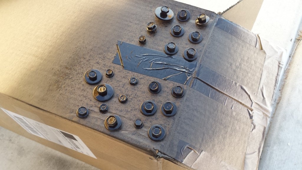

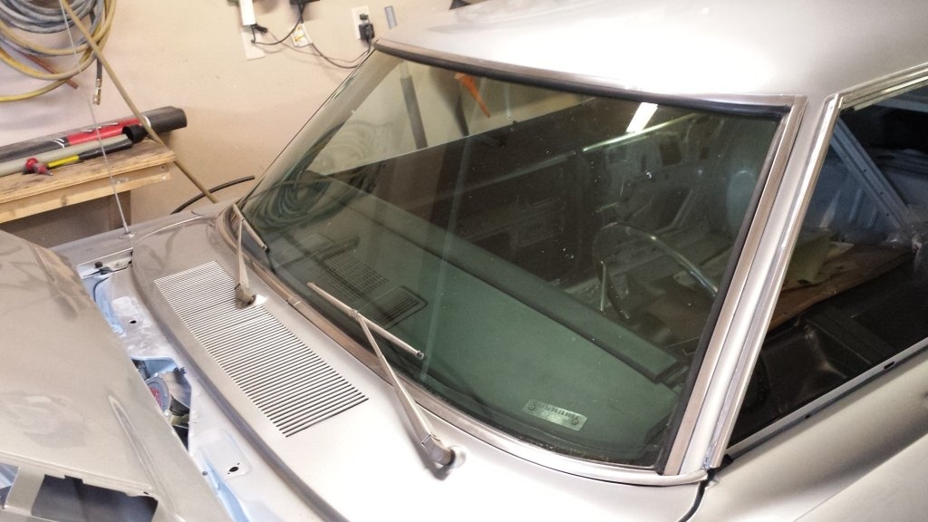

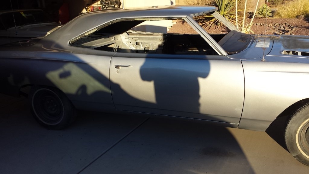

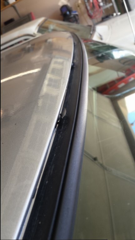

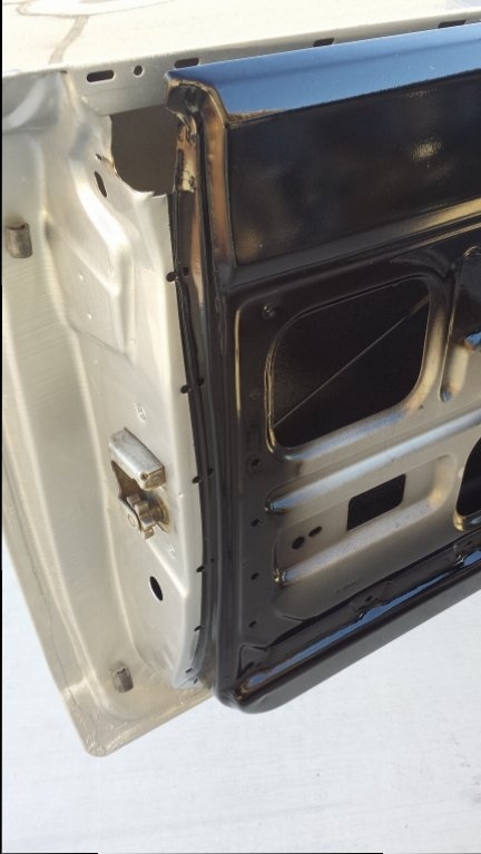

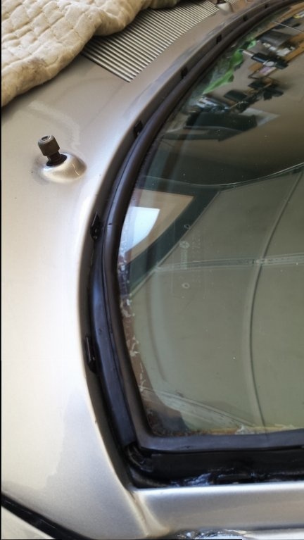

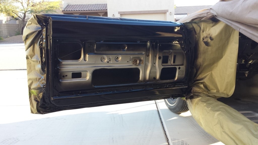

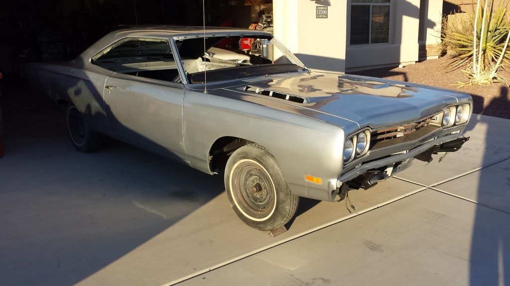

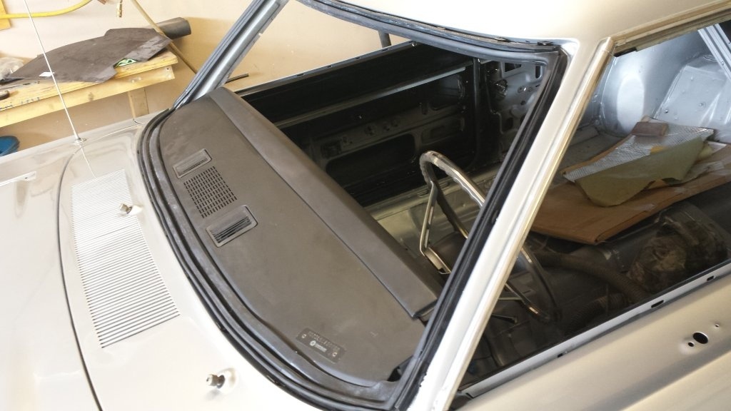

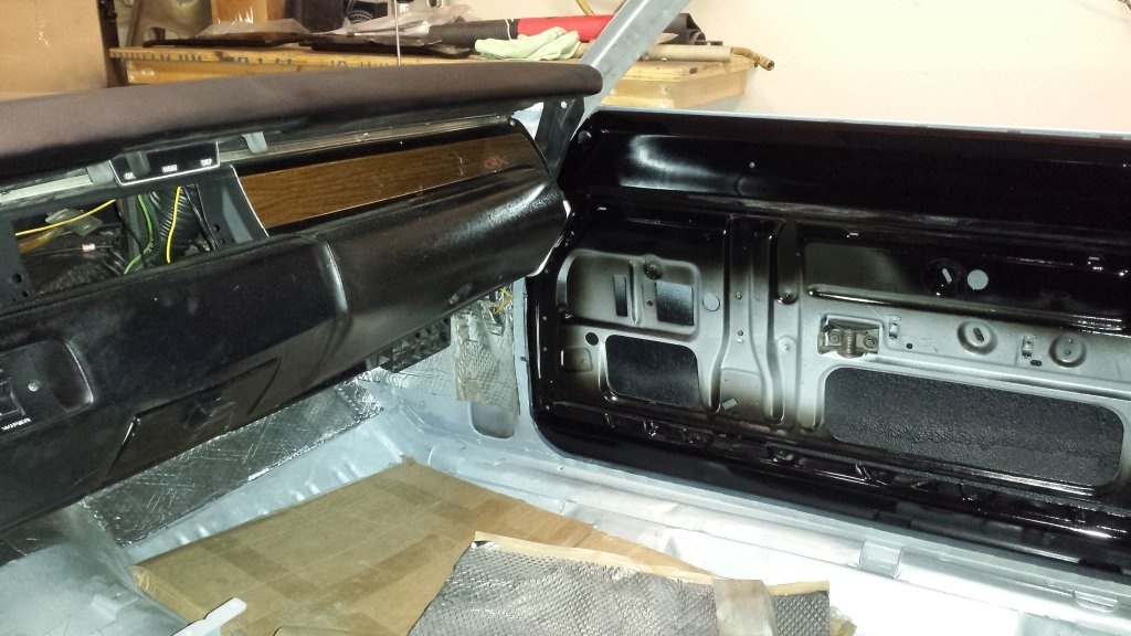

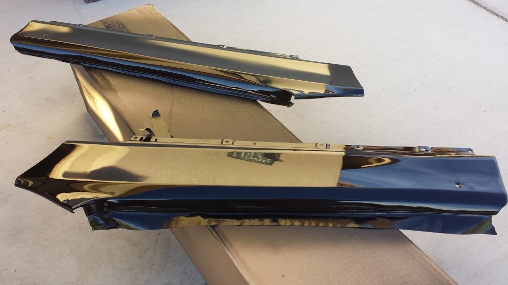

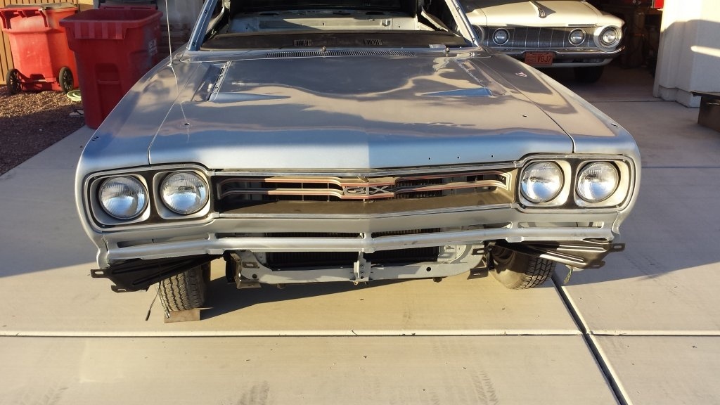

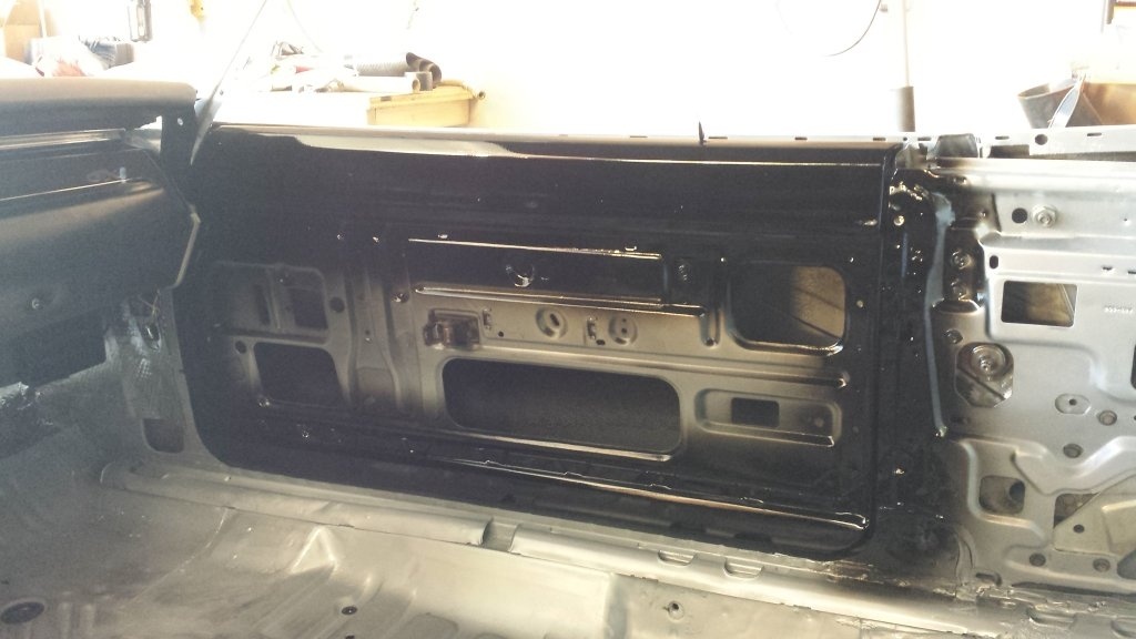

Got a little bit done. Picked up some single stage Utech urethane in black to do the interior doors and hood (with flattening agent) at a later date. So I rolled the car out and taped off the jamb area and threw a beater cover over the rest. Weather was nice today, scuffed the clear, degreased, tacked and shot. The rear upper panels looked like glass (wish my clear sprayed that good). Also shot some random bolts that had been blasted. Turned out pretty good I think considering I kind of half a$$ed it. Looks decent in the sun but I found a small area near the headlight that is light in basecoat. I'm not too worried about it, more things on the plate.
