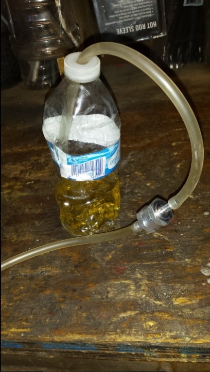

I think my brake situation is fixed. Got around to bleeding them again and the pedal has remained firm. Here is my one man bleeder kit. Works soooooo much better than the vacuum bleed for me. One way check valve is off amazon and made for diesel cars. Fluid and air go out but can't get back in.

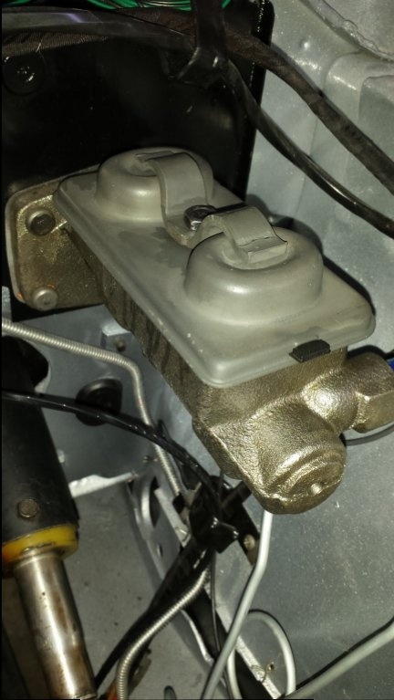

For my master cylinder, I bought one of the new bolt down flat top units and re-used my old top and hold down. Drilled the holes larger in the lid and hold down as the new one is bigger. Used a hole punch to open up the hole in the rubber seal. Looks stock-ish
