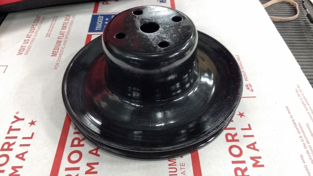

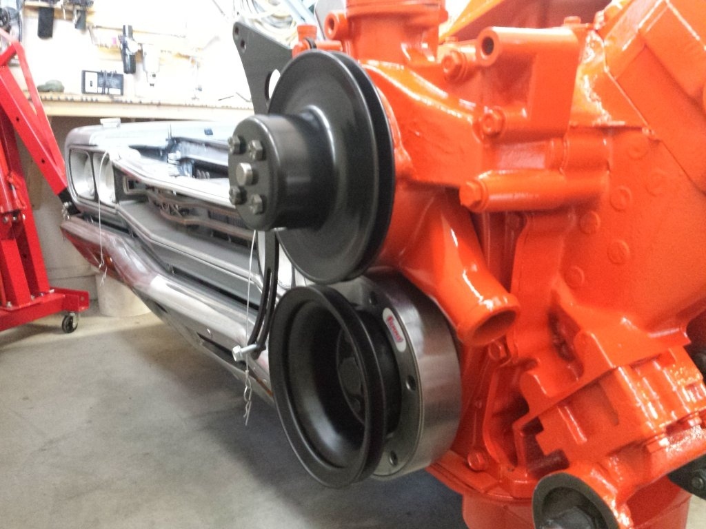

Here's the pulley if your interested PM me. 40$ shipped

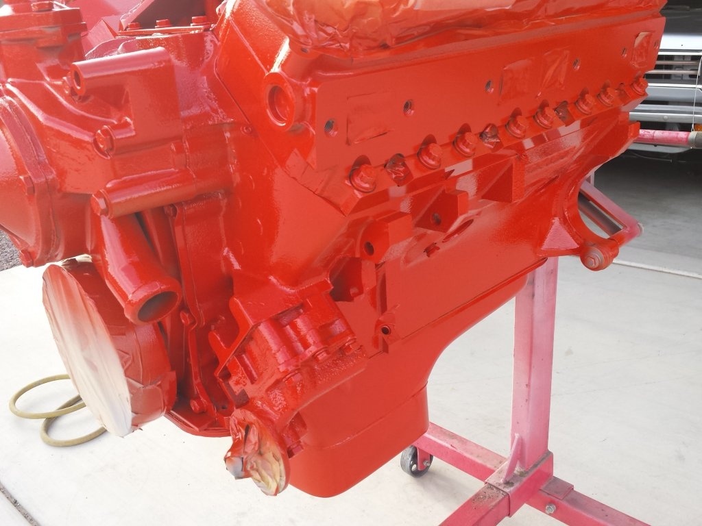

Ready to drop in!

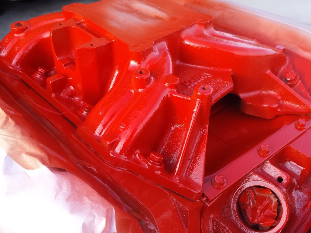

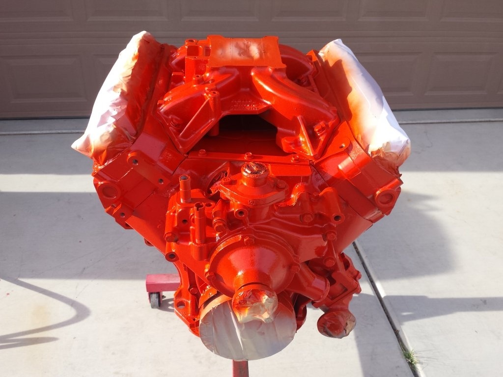

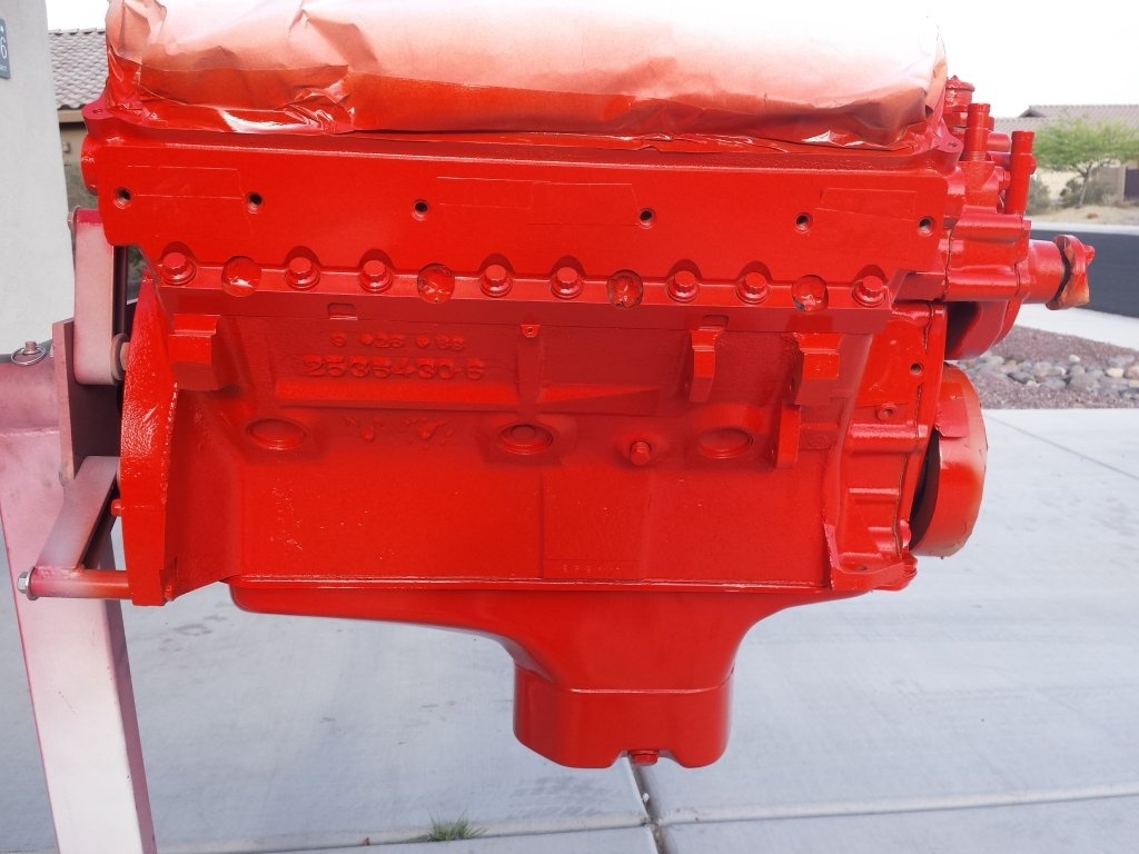

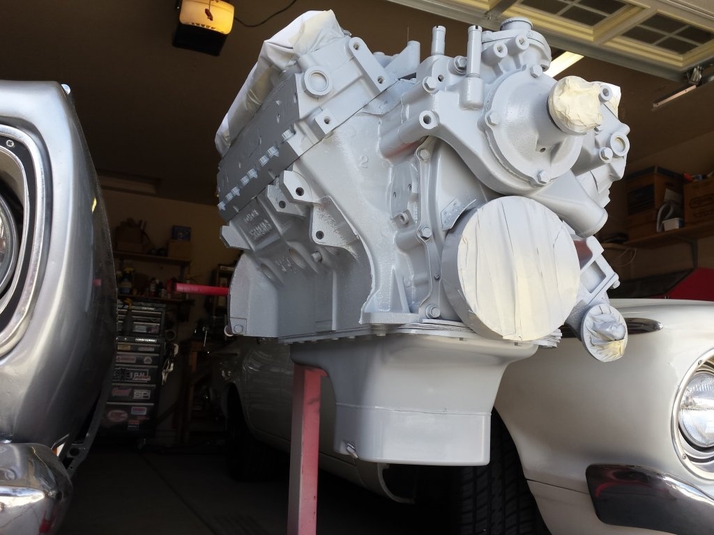

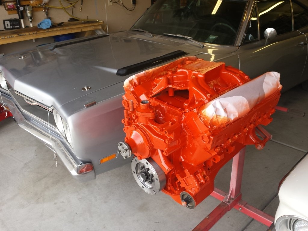

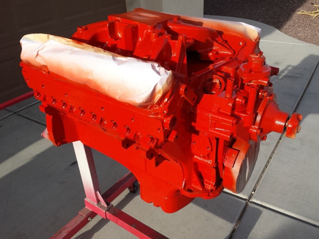

Gun is an Astro Evo set to 20psi at the gun, paint is U-Tech single stage urethane. Paint code is FLC which is the newer Hemi Orange. Covers excellent. And I found out my paint supplier is going to stop carrying U-Tech and go with Advantage :(
Are you going to shoot it with SPI clear? It really makes it much more durable and resistant to chemicals than the rattle can.

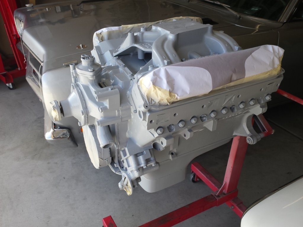

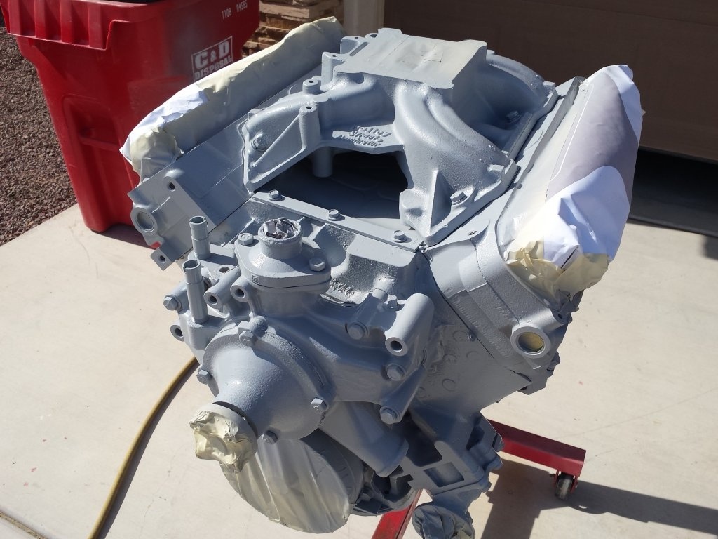

With that tall manifold, will the hood close once the carb & air cleaner are on?
Yes. The Dominator is not very tall for a single plane and many have used it on 68 to 70 b bodies. The RPM is taller and has clearance issues.

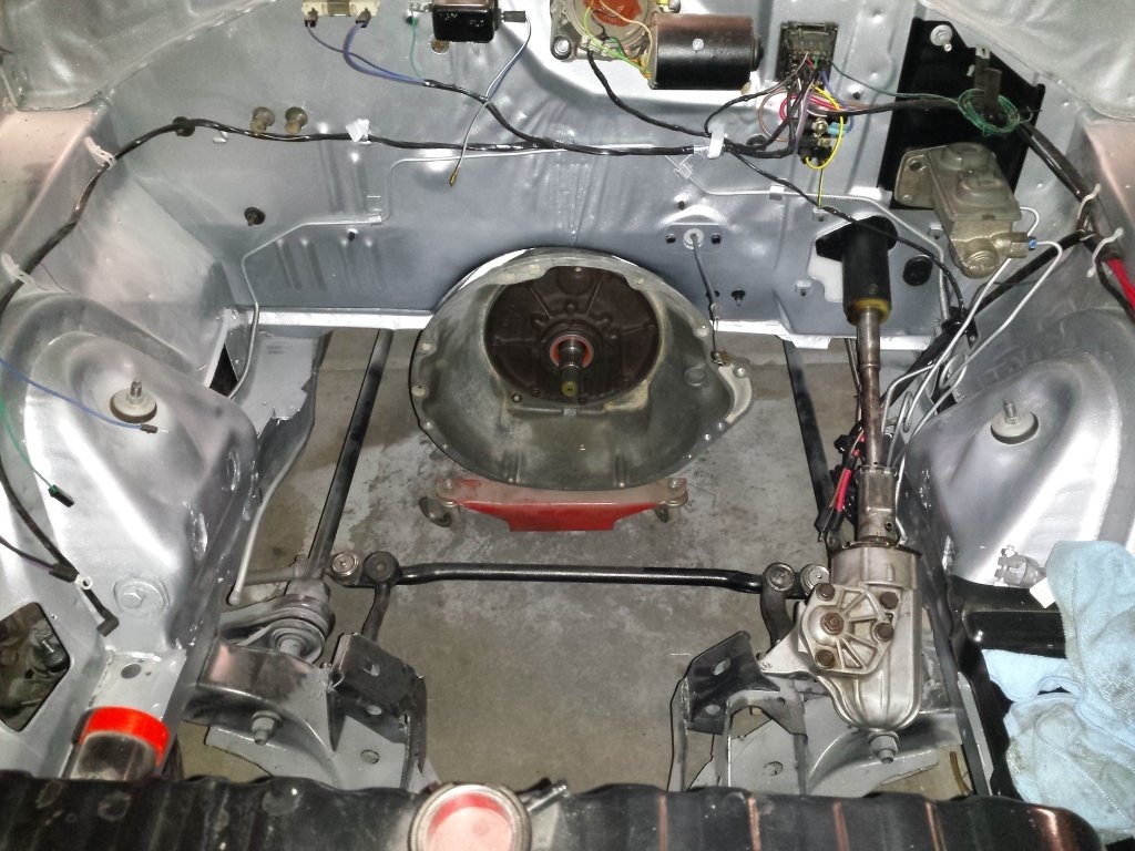

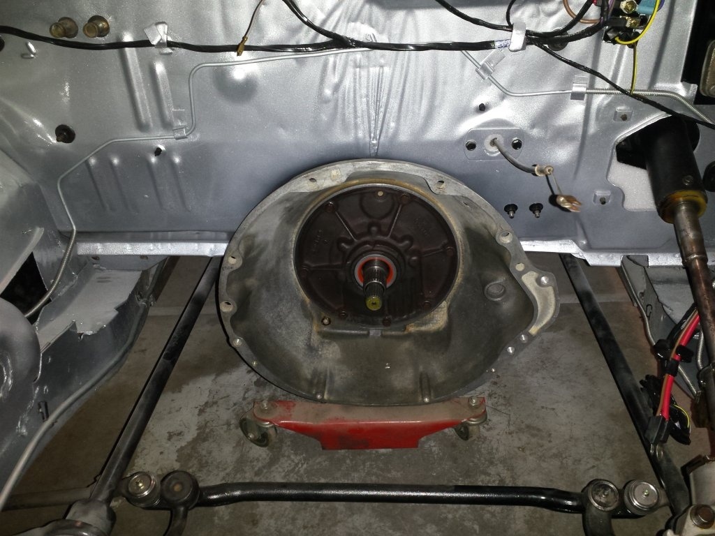

Transmission is in. And I got the motor mounts bolted to the engine.

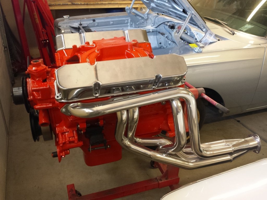

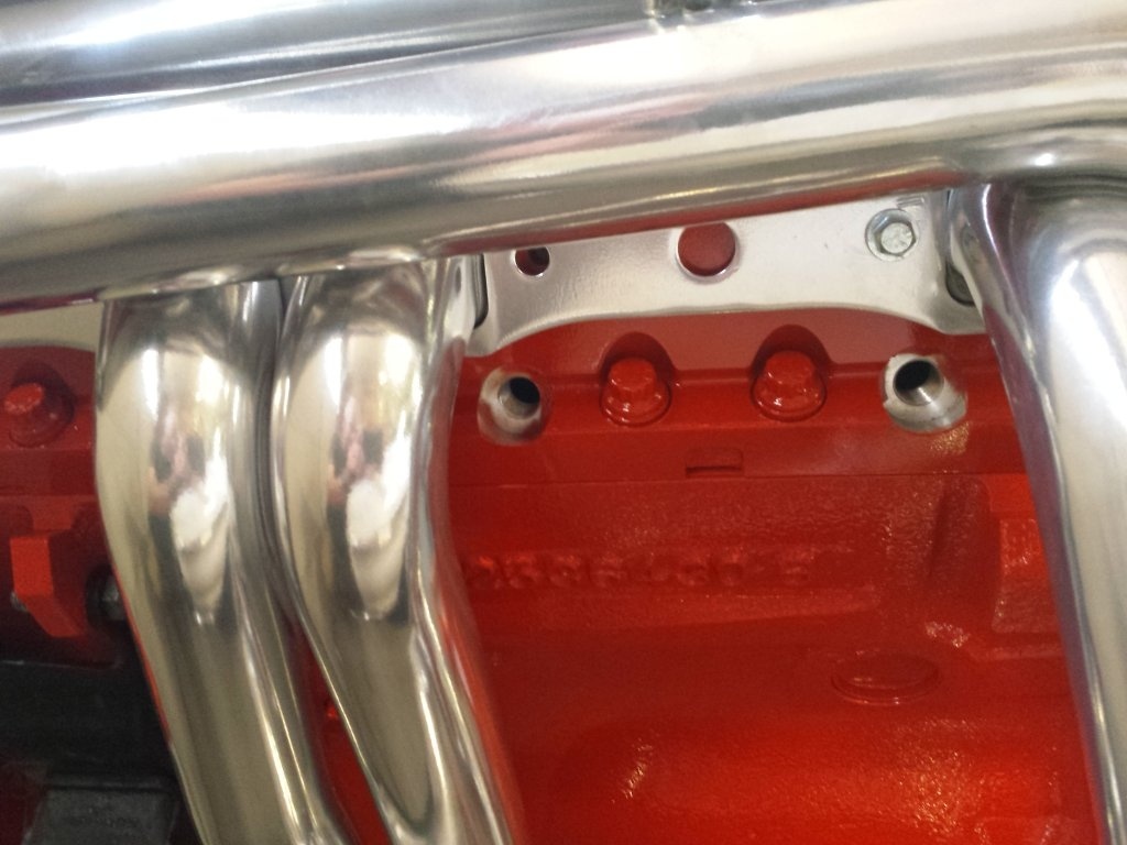

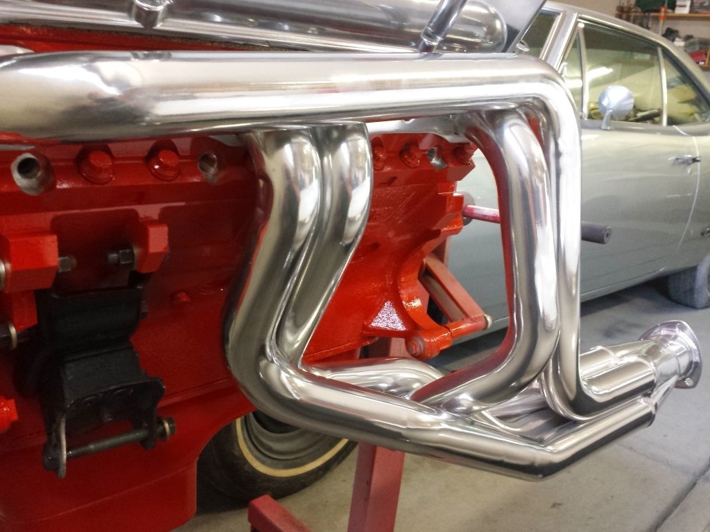

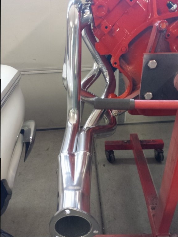

The auto parts Santa (Fedex) brought some gifts of the shiny persuasion....
440 Source valve covers / pulley and Jegs ceramic coated headers!
Don't forget your dipstick. Easier to deal with a problem now, than when it's in the car. Don'the ask how I know.
