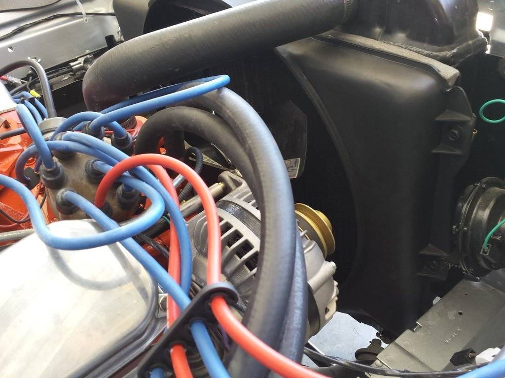

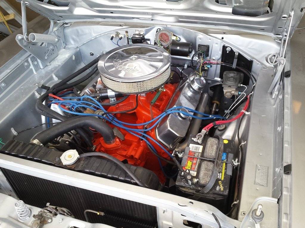

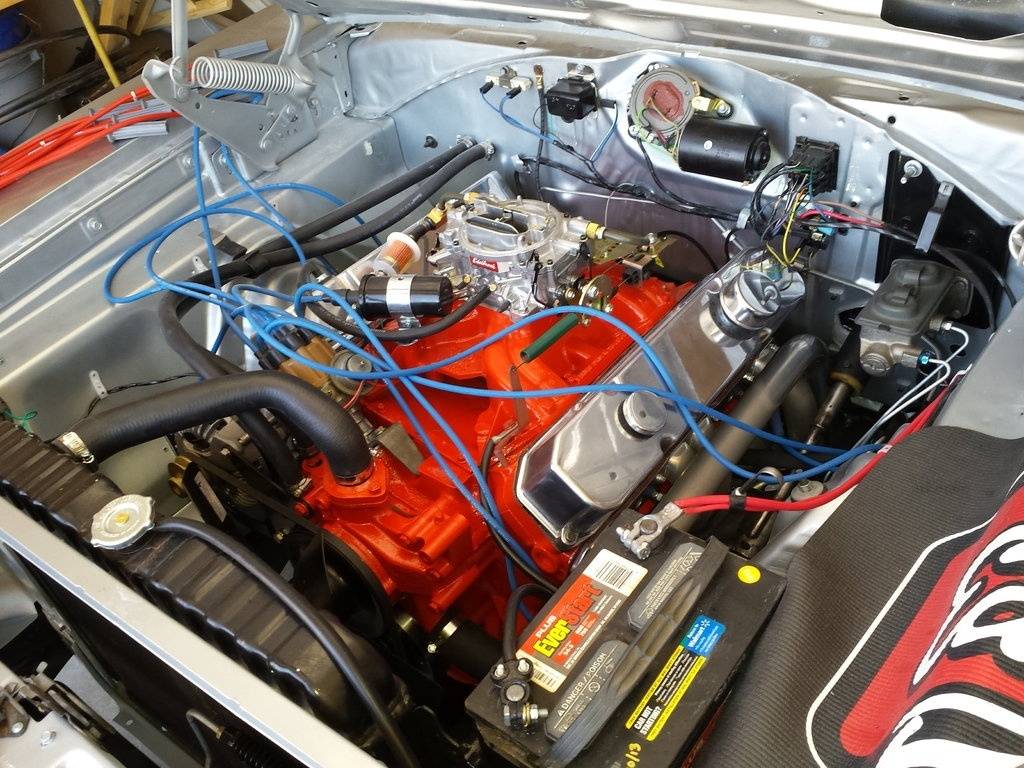

What a day. I should have known it was going to be long when the throttle cable snapped at the carb as I was priming the motor. After some minor repairs, a lot of sweating, a weeping freeze plug, many adjustments, 2 spark plug wires caught on fire, dust shield clanking from the converter bolts, and one overheat, it is running and broke in. I still need to tune it and swap in the dual springs.

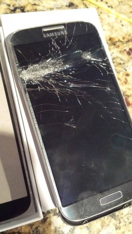

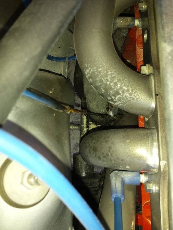

The first start up lasted only 10 minutes before it started to overheat so I shut it down. Probably due to timing and lack of thermostat. I would have got video of its' start up but my phone got smashed in my pocket somehow. The Taylor plug wires that are listed for a 440 were waaaaay too long. I had the pass side 6 and 8 laying on the fender while plugged in. You can see the two red ones as the original two were burning pretty goo (I had an extinguisher handy).
View attachment 432083 View attachment 432083 View attachment 432084 View attachment 432085 View attachment 432086 View attachment 432087
oh hell ya man congrats. sounds mean. tune that baby in and get cruising. lol if its not one thing its always another. ya i got taylor wires for my 440 in a motorhome, WAAAAAAY too long. i prefer buying the kits where you cut them to length and crimp them. get some nice wires looms take you time and they look phenomenal. i had those kevlar nomex woven boots on a chevy 350 i had, kept melting the damn things, terrible design. chevy... whattya expect. mopars not much better but at least the angle the plugs so only a couple are close. i know its sacrilege, but thats why i like pontiac motors, plugs are on top completly out of the way of the headers. of course, the best way to keep the wires away is by getting a hemi haha

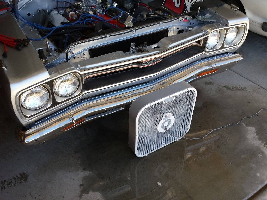

I assume your garage has GFI on the AC outlets. I cringed seeing that cheap box fan in a puddle of water. Just be careful.
Thanks!. It is GFCI and I moved it off to the side after I began hosing it down. The puddle formed when water spewed out the overflow while I was in the car.

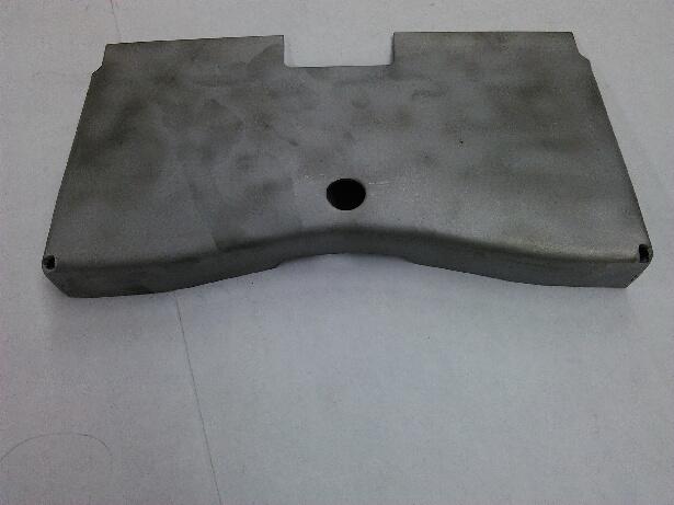

Need a skid plate for the Kmember

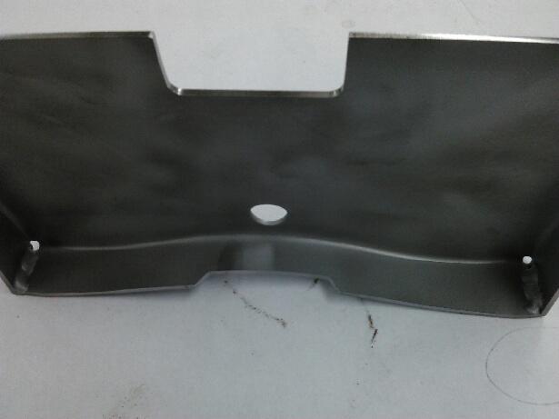

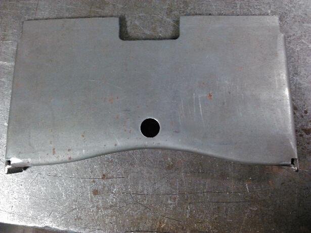

I got the pan skid plate out to prep for welding on.View attachment 266053
I didn't like the looks of the welds on the outside with the extra material. So I cut that off and ground it smooth.
I then bead blasted it to get all the laser scale off the cut edges.
Then I welded the seams on the inside and reblasted the welds. I was careful to leave the drain holes open. I will prime & paint the inside before welding to the K frame. I then ran out of steam from the heat and called it a day.
You could make one pretty easy if you wanted to save 125$
There are more pictures around post 410 on my thread. I'll try to snap a picture this next week. pretty simple.

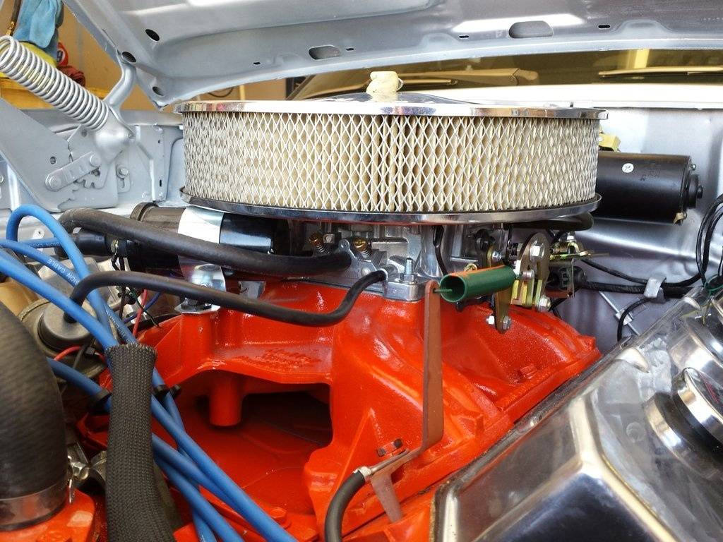

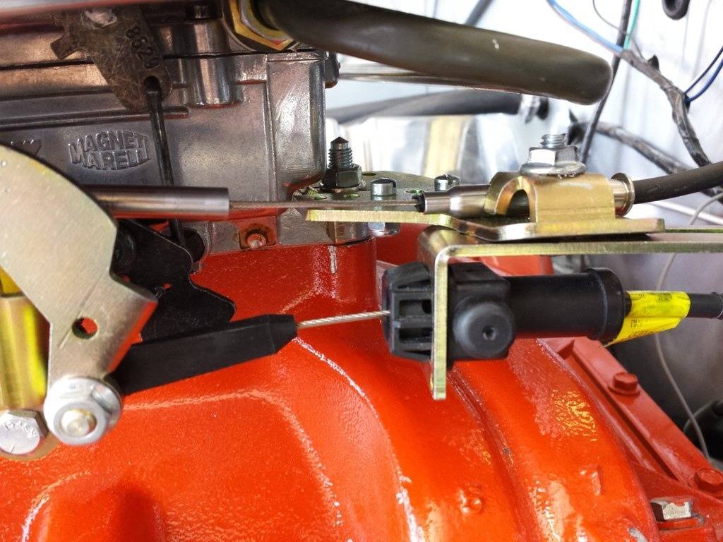

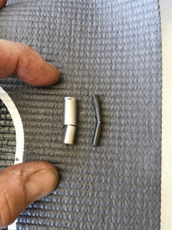

Mancini Racing is on my $hit list... The $80 throttle cable didn't have enough pull to go full throttle on a stock carb throw!!!!! The ferule and the plastic sleeve were too long and binding about 3/4 throttle. It was sold for 65 to 70 B Body with after market intake. Yea, so I modified the overpriced crap so it could work. Should have went Autozone with this....so pissed and more wasted money.

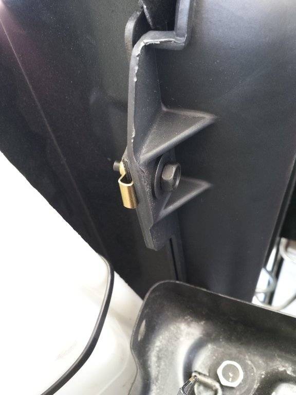

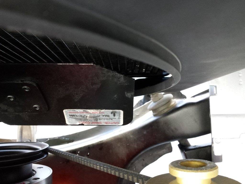

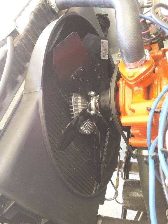

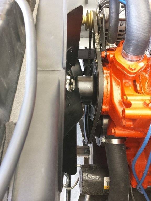

And I finally received my fan shroud after the first one was damaged in transit and returned to shipper. The replacement was cracked....FML. So I superglued it because I didn't feel like waiting another 2 weeks for a $150 piece of molded plastic. And the opening is 21" and my fan is 18" so I may need to find another fan. I'll try it first but any opinions on whether the spacing is too great between the fan blades and shroud?

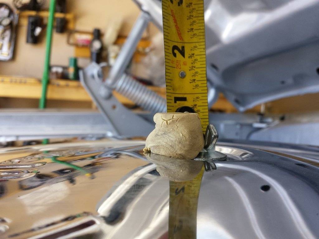

And if anyone is curious, here is the clearance from the hood to the wingnut (Edelbrock 3" air cleaner, Edelbrock AVS, Holley Street Dominator).
