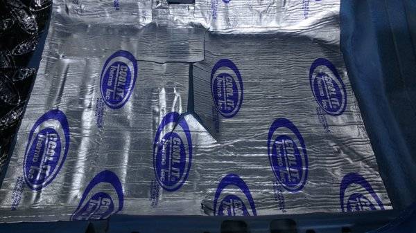

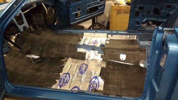

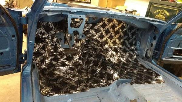

Have you had time to drive it to see if there's a reduction in noise? I put sound deadener everywhere but under the rear seat. Wondering if it needs it?
To the store and back and it did make a difference. But I can still hear the pump whine but not as bad. I'll be taking it on the highway today so I should get a better idea. I only did the area between the frame rails as shown in the pic. They were "tinny sounding" when tapped and the mufflers are under it.
I tried to over kill mine I used lizard skin inside and out, then Dynamat then rubber
I may get some more for under rear seat.

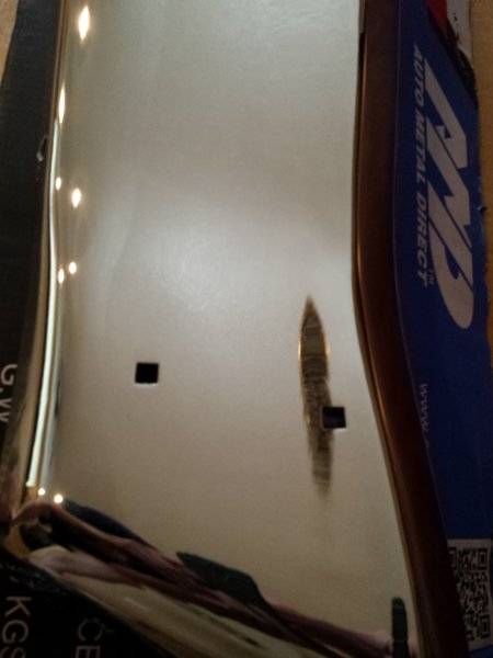

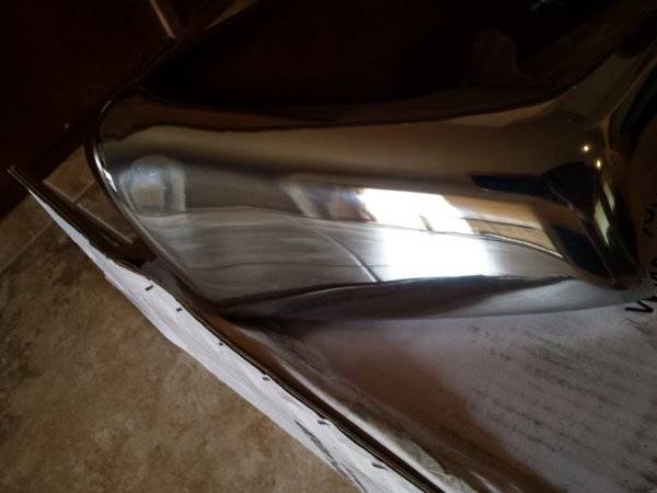

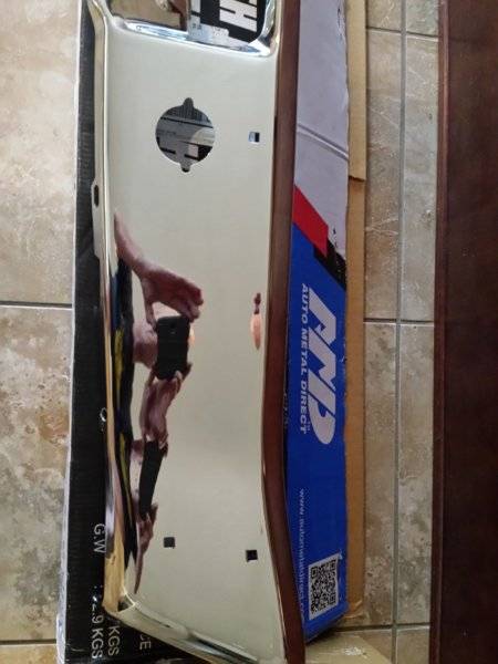

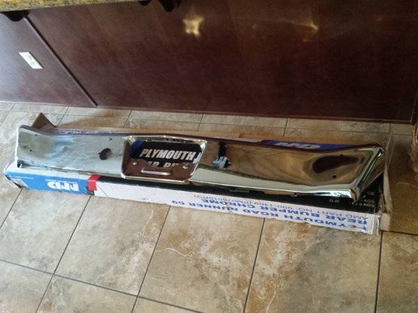

I just unwrapped my AMD bumper and I am quite happy with it. Chrome is like a mirror and sub surface is perfect. I'll weigh it against the original to see what difference it is. Next month I'll order the front.

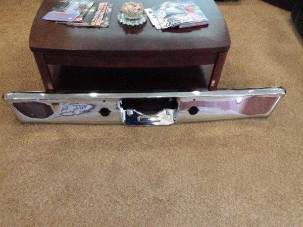

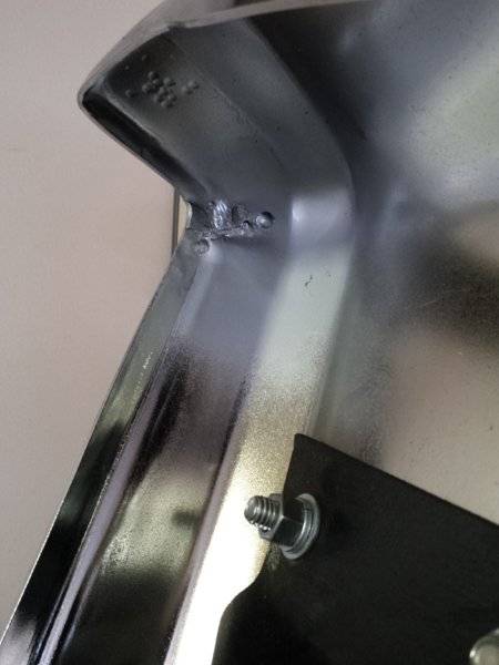

I got the bumper installed, no issues with fit. I weighed them both with a fish de-liar and the original is about 22 lbs and the AMD about 21.5 lbs. Decent chrome on the back, the corners are welded so probably not a good resto piece but they are still very nice.

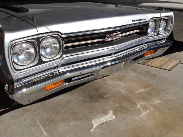

I had my thanksgiving dinner a couple days ago because I work today. But I did have time to install my AMD front bumper. Looks great, and made my old one look even cruddier in comparison. I had to tweak a couple brackets but it fits perfect.

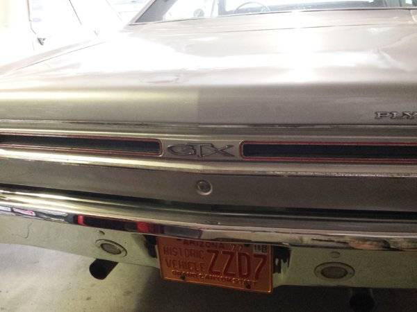

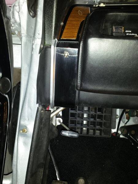

A couple more pieces to the puzzle. Got a rear emblem, thanks Tim! and I found a lower dash trim piece. I was missing mine and this piece was $12 shipped so it will do for now until a nicer one turns up. Cleaned, glued the crack, painted the chrome strip and installed.

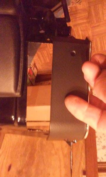

What does that screw on the face of the lower dash side trim plate go into? Mine was missing some stuff. I see where the bottom screw goes but there's nothing behind the top one/s. I broke down and bought a new set off ebay the other day.
It goes right into the metal dash. If your hole is wallered out you can use a sheetmetal nut on the back.

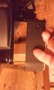

As you can see in my pic there is no hole because there is no metal. In the pic I'm holding the passenger side trim plate to the right 1" from where it goes. My car had a/c vents there before so I'm assuming something is missing for these to screw to. There may also be a difference since mine is a charger rallye dash and frame.
