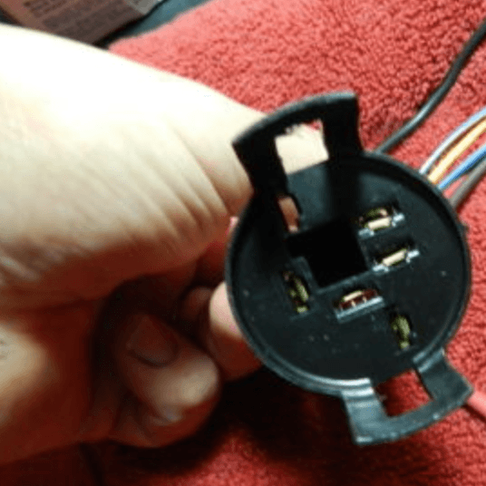

This is the connector plug.
Terminals will pop out. Use a pick to push down the notch, it'll depress a tang and allow it to be removed. Do you need the female terminals or the plastic piece?

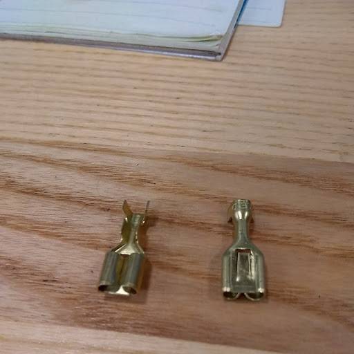

Just the female connectors; the plastic piece is a little stretched out but still seems to hold onto the metal ignition switch. I will gladly pay you for them. I got them to pop out; they were badly distorted over the years. Thanks
Take a picture of one, I'm sure I have some. Are they zinc or brass?
If not I'll check my old harness tomorrow.
