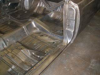

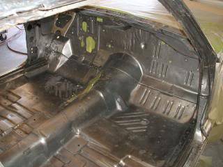

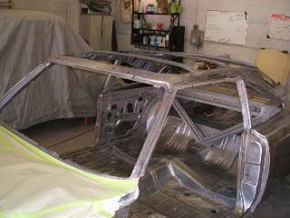

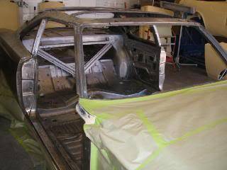

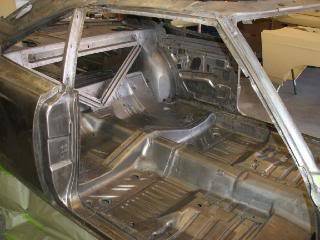

We took the car to Redi-Strip Tempe and had the shell dipped.
We sand the metal down to shiny finish and give the metal a tooth for the epoxy primer to stick to.

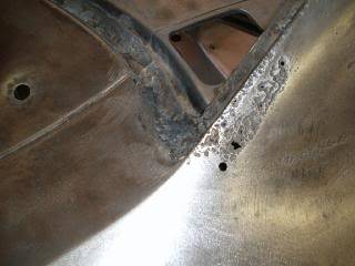

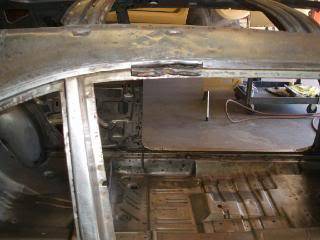

Redi-Strip damaged the roof structure and the vinyl top destroyed the roof skin.

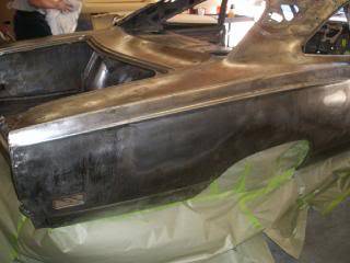

Couple small rust spots in the right quarter panel welded up and filled.

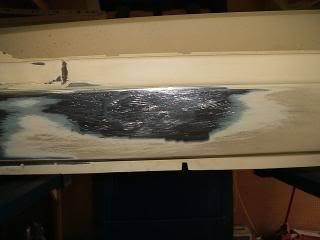

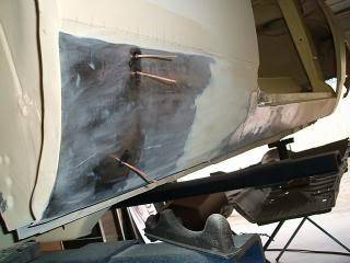

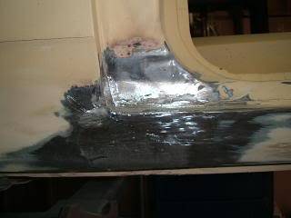

Replacing the factory lead and lead filling a couple dents in the lower right quarter and rocker.

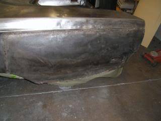

Time to weld the AMD panel on the Road Runner.
Little metal work getting ready for lead

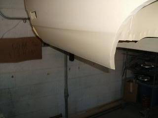

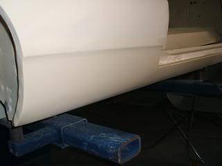

Bodywork on the right Quarter

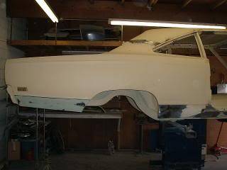

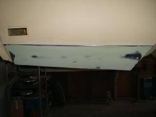

Bodywork and Primer on the right side.
Bodywork Down the Left Side.
Bodywork continues

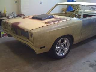

Couple Pics as our Project is near fully mocked up.

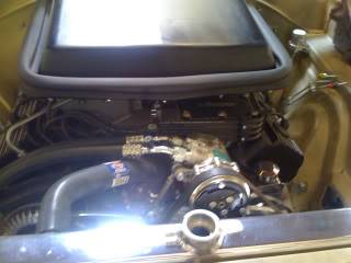

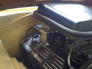

The Fabricator just Completed this Shaker Assembly for The Cross-Ram Dual Quad
This shaker assembly came out very nice a perfect fit.

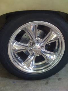

Close up of the Foose Wheels

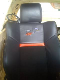

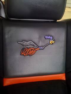

Getting ready to get back at our bird's paint and body but we are finalizing a few details as we go. Starting off with a set off 2010 SRT-8 Challenger seats (2-door with fold forward backs) with the Road Runner embroidered into the seat backs.
He had the front and back seats done. Then the Road Runner engraved billet steering wheel.

Wow, those seats are awesome, especially with the embroidery, and the engraved steering wheel is a totally sweet idea!
The shaker setup looks really nice too, definitely not something you see on Bs.

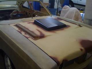

Looking to order up some supplies this week and get started on the roof as it has been decided to paint it instead of replacing the vinyl top.
I was digging it until the hood, that's just not for me at all, but man what a sweet build otherwise ...
x2...that scoop just isnt doing it (maybe that scoop on a satellite hood?) , but hey if the owner likes it thats all that matters! Very nice project otherwise
I like the idea of something a little different but the 3 scoops looks a little weird I agree the shaker on a satellite hood would look cooler,like the interior,its your car though so as long as your happy go nuts!! Nice work!
you are definitly going different on this,but i will reserve my opinion until you get her painted but looks good so far,
