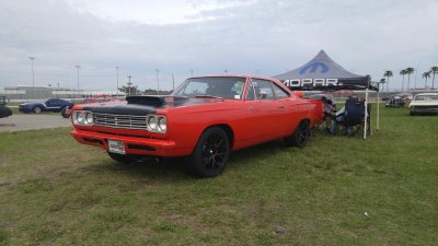

(1st picture)
440 10:1
Victor SP
Proform/Holley 750
.590 MP Camshaft
4-Speed, Hurst 'pistol grip' tall shifter, and Centerforce Clutch
8 3/4 w/ Richmond 4.10's and locker
MP SS Springs, 90/10s front, and C-Body rear shocks
SSBC front and Baer rear brakes
28x4r15 front M/T sportsmans and 30x12r15 rear M/T DR's. 15x4 front, 15x8 rear Jegs Draglite replica's.

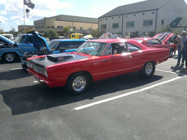

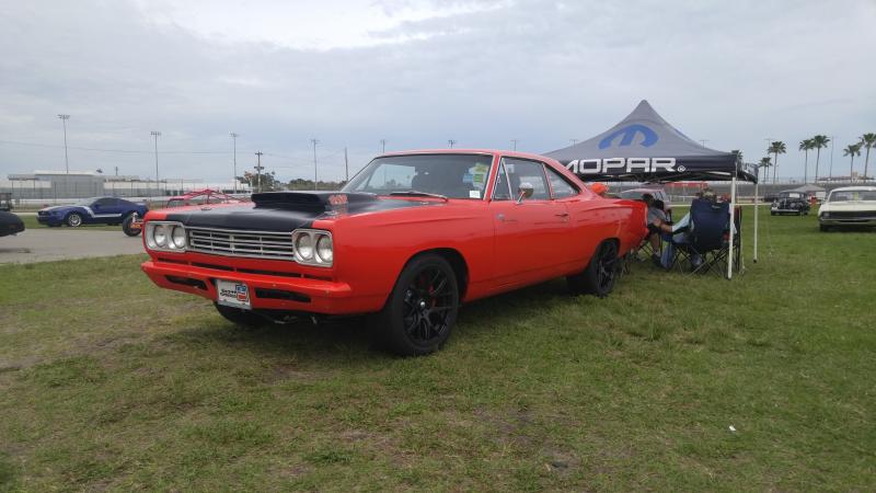

(2nd Picture)
440 10:1
Victor SP
CSU 750 BT Carb
BW S475 T6 Turbo
A2W intercooler
Snow Performance Stage II Meth Injection kit
.528 MP Camshaft
727 w/ TSI 3400 converter, Art Carr shifter, and TA RM Valve Body
8 3/4 w/ 2.93 C-Body gears and locker
Hotchkis suspension and MP SS springs
Dr. Diff 13" Brembo front and 11.75" Baer rear disc brakes
27x10r18 front Nitto 555r2's and 28.5x11.6r18 Nitto NT05's. 18x9 front, 18x10 Hellcat Replicas.
