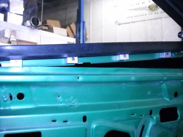

they don't go over the quarter panel, they tuck in between the quarter window frame and body ...

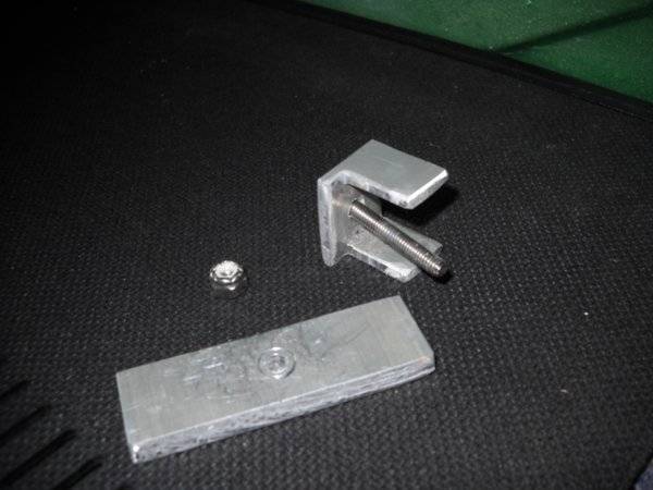

If you replaced the quarters then there is a fitment issue. I had to make some pieces to get the gap closed on mine.
can u send me pics thanks
I have material left over if you want me to make you a full set for both sides. PM me and we can set it up.
