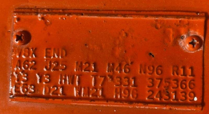

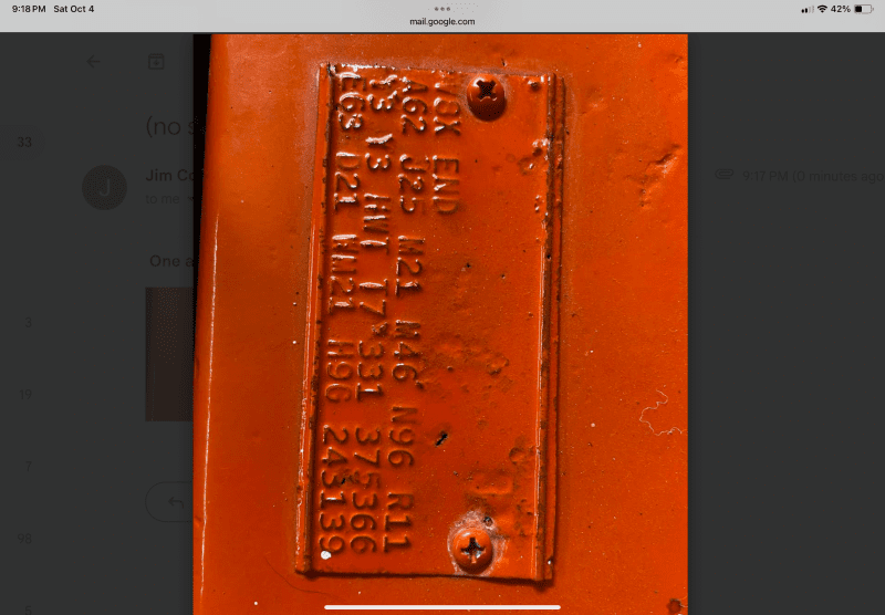

I am picking up a 1969 Super Bee project this week and have a couple questions on my fender tag. This is what I figured out so far, but there are a couple I am not sure of….Thanks in advance!
E63…..383 4 Barrel HP
D21…..4 Speed manual HD
WM31….Dodge Super Bee 2-door coupe
H9G……383 CID V8, 4-barrel carb, 1969, Built St. Louis MO
243139…..VIN Sequence
Y3…….Body Color Cream (Dodge)
Y3……????
HWT……Interior Door Frames. (Does this go with prior Y3 code so doors are painted Cream inside?)
T7……????
331…..??? Build date March 31st?
375366….Order sequence number
A62….Rally Instrument Cluster Package
J25….3 speed wipers
M21…Roof drip rail moldings
M46….Simulated Quarter Scoops
N96….Fresh Air Hood
R11….Radio Solid State AM two watts
V8X…Black Bumblebee Stripe

The 2nd Y3 is roof color. 331... you are correct. I'm interested in finding out what HWT is (error?)...H=high grade...W=???...T=saddle tan.
E63…..383 4 Barrel HP Only tells us 383-4bbl. It does not tell us WHICH 383-4bbl and associated horsepower rating came in the car.
WM31….Dodge Super Bee 2-door coupe WM21
Y3……???? St. Louis plant does the upper and lower colors twice even on monocular cars.
HWT……Interior Door Frames. Typo. Should be H2T (see the relation to the "W" and "2" on the key board) indicting interior trim level, seat type and color. High trim level, vinyl bench seat, tan in color. See link below for sample.
T7……Inner upper door frame paint tan to match upholstery.
331…..Scheduled production date (SPD) March 31, 1969. Unlikely to be actual assembly date.
