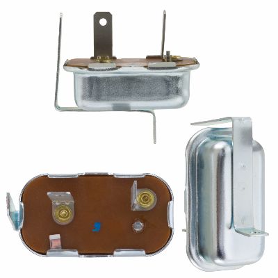

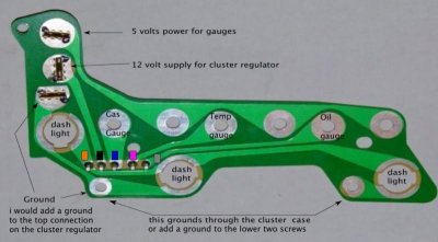

Voltage Limiter
It' good you found it... Usually when both the Fuel & Water Temp gauge qiut work together, it's the voltage limiter that is usually the main cause... Or sometimes the printed curcuit board... these examples are for a 68 Charger... It was probably corrosion or oxidation with in the many dash connections...
