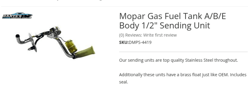

I can't answer that. I only know it works with the original in dash gage. And if so, why use an aftermarket gage?Yes, but will it work with aftermarket gages? (Sounds like you’re good at sharing) lol
Cuz im thinking if all the gages don’t work, the printed circuit is probably bad including the fuel gageI can't answer that. I only know it works with the original in dash gage. And if so, why use an aftermarket gage?

8 gallons should be around a 1/3 tank I believe they are 19 gallon tanks. so in math 5 gallons is a little less than a quarter. These gauges were not that precise from the factory IMO. if your gauge reads empty accurately and full accurate. you can guess the restSo if my gage reads just above empty with 8 gallons in tank, its just an adjustment like the video?

Unfortunately, as mentioned in post 1, mine reads a hair above empty with 8 gallons in the tank. Am aware they dont read accurately, but as you said, with 8 gallons should read “around” 1/3 to just under 1/28 gallons should be around a 1/3 tank I believe they are 19 gallon tanks. so in math 5 gallons is a little less than a quarter. These gauges were not that precise from the factory IMO. if your gauge reads empty accurately and full accurate. you can guess the rest
