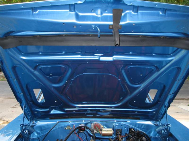

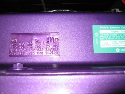

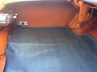

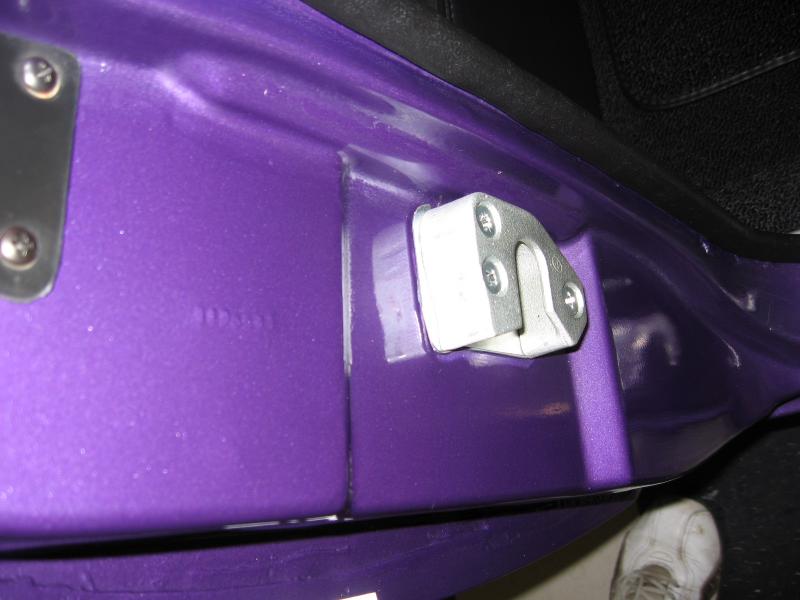

HERE'S a few small tips that you see wrong often.
Hood safety should be Black Phosphate with bolts but hood catch bar and bolts should be body color.
Hood pop up spring also Black Phosphate NOT body color. Hood latch could be Black Phosphate or another coating but no body color.
Trunk catch and bolts body color but not latch mechanism.
Interior inner door frames are called out on your fender tag NEVER body color same with reat upper door frame.
Door latches and strikers NEVER body color .
All fender attachment bolts painted with underhood also hood hinges and bolts.
Don't paint the bolt at the rear of front fender opening that attaches to inner fender sheild, it should be Black Phosphate and also lower bolt and bar that holds the bar to the front bumper bracket.
That should start you off for now. IMG_3063.jpgIMG_3062.jpgIMG_3069.jpgIMG_3033 (Large).jpgIMG_0020.jpgIMG_0036_1 (Large).jpgIMG_0367 (Large).jpg

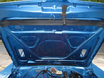

lol....... ask, and you shall receive :HappyNewYear:

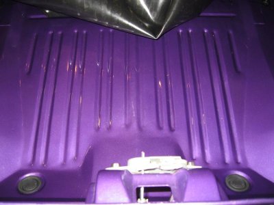

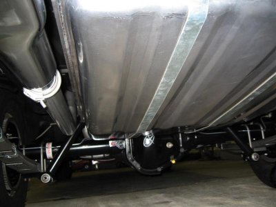

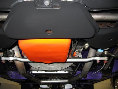

Here's some although not OE perfect they are better than most.
The upper control arms should be bare metal look and can have Cosmoline on them like lowers.These in the picture were sprayed by a previous owner.
