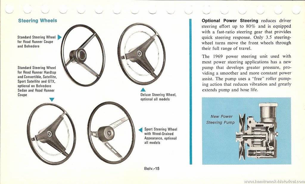

Wanted to know what kind of steering wheel the 1969 roadrunner had in it. Totally restoring my car and want every thing original. Was told the wheel was the same color of car with half metal horn ring with roadrunner in the middle.(cap) The I was told the wheel was wood. The wheel that I had in the car was wood with no half horn ring. I am pretty sure this wheel was put in car. Can sure use help. when looking on the web keep getting different answers with different kinds of wheels. THANKS Nick
The actual type steering wheel and color may only be called out in on the BS (not sure of it though).
RR Decor package is A87. S81 is the woodgrain. Except for the woodgrain, the colors were medium blue, dark green, black, dark red, and gold.
Check out http://www.hamtramck-historical.com/library-2.shtml for lots of useful info.
