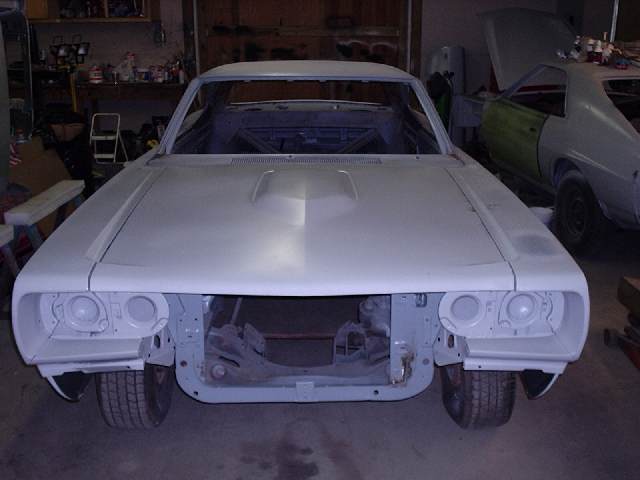

if possible, I align all my panels and do all my bodywork while the car is still assembled..... if door hinges need addressed, that is first........then everything painted in pieces and reassembled...... colors like silvers and golds can be tricky and slightly alter the paint plans

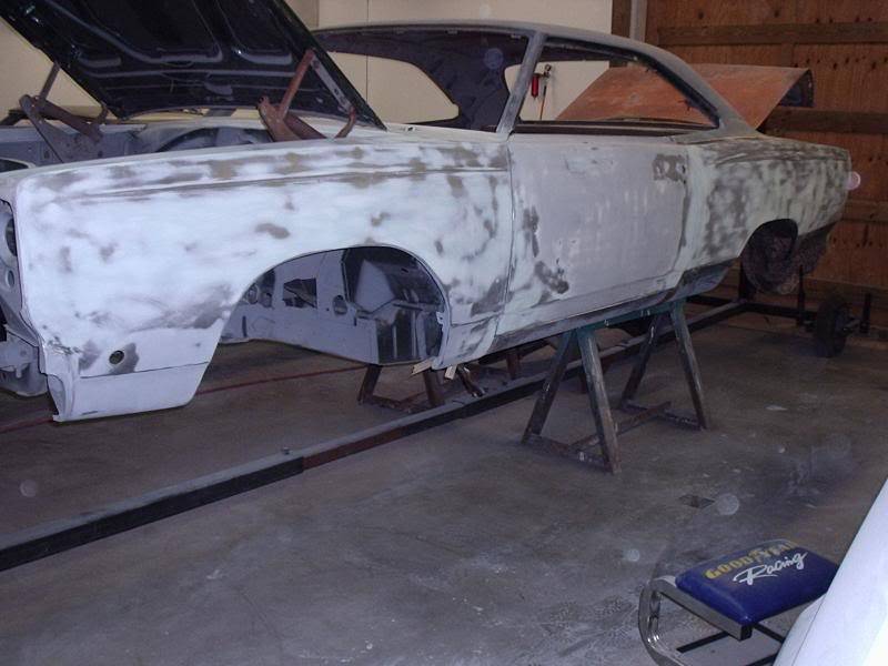

i misread, you are already on a rotisserie ....... I have a set of steel horses, I lower the car enough to get some support in the middle and hang the doors; The castors may work fine, but the key is getting the doors parallel to the rocker.Next I mock up the front and do all my body work (at least where all the panels meet); then break it back down for paint....... how it fits before paint is how it fits after paint, it's the perfect example of measure twice, cut once
this is my preferred way as in post 10....... all the pita work done and fit prior to rotisserie
