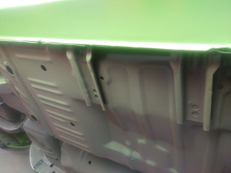

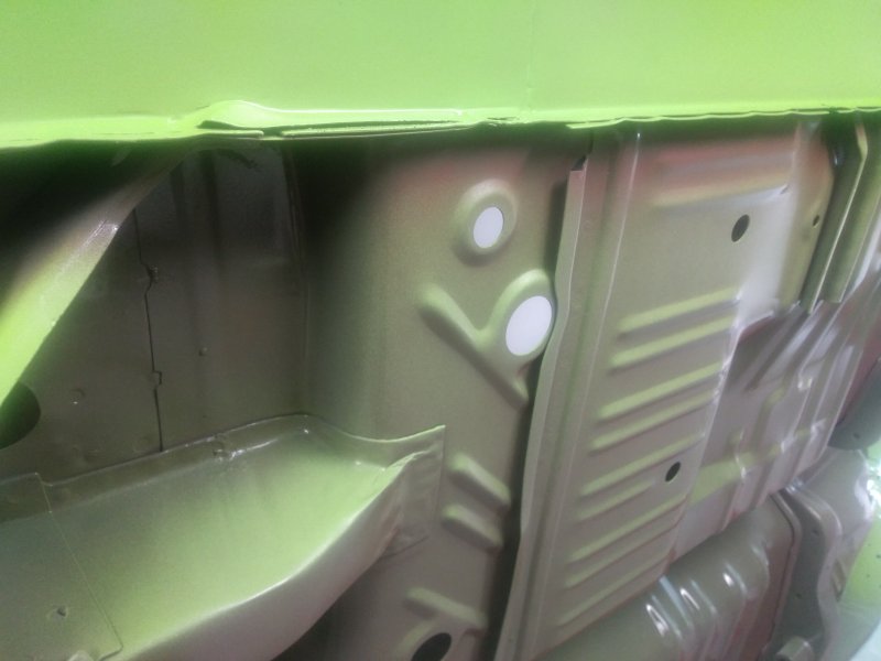

...... I have found a green/blue/greyish coating under factory undercoat`on many cars....... I had some semi flat military green single stage on my shelf and played with it a little to get it close........ then I used red oxide primer around the edges, cause red oxide primer is used under the top coat paint....... then let the green go where ever when painting the exterior, covering most of the red oxide

looking at my pics, I guess I did it separate from the exterior paint; as you plan to do........ tomato/tomoto

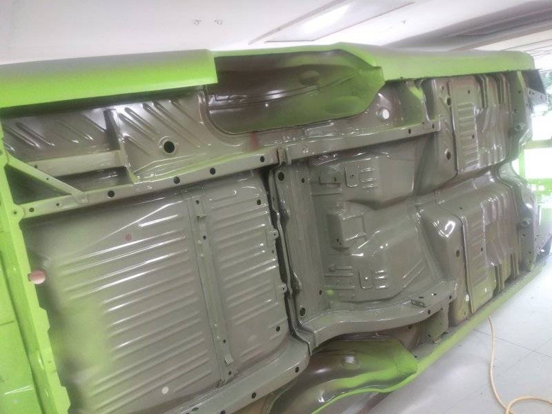

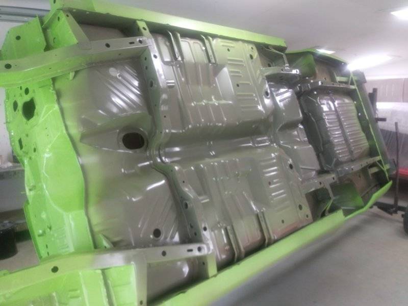

View attachment 1791406View attachment 1791410View attachment 1791409
Beautiful! Now you have me thinking...
