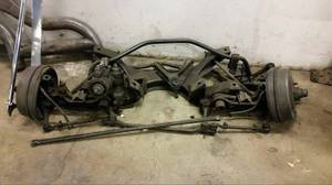

Hello my question is I have a complete front suspension out of a 1969 charger RT car. Can this bolt into a 70 RR with no problems. It has power steering and sway bar tabs on the lower control arms. Are these B body parts interchangable? Also not sure where to ask this but what's it worth?
Should bolt up... Not sure about worth.. It depends on if someone NEEDS it.
The Inner & Outer Tie Rods are different -- have a different angle to them......
The 1970 - 1976 Inner & Outer Tie Rods are far cheaper than the 1962 - 1969 s......
So if you put it in a 1970, you will need the ES401L and ES401R Inner & Outer Tie Rods......
(Sleeves are the same.)
It will work, as far as WIW easily between 500 to 1000 if you tried to get everything separately not counting shipping. But if someone just had it sitting around and wanted to get rid of it you could probably get it for under 500. start at 300 and work your way up and bring cash that usually motivates most sellers.
Too bad it doesn't have disc brakes, that would increase it's value.
