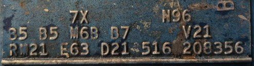

Hello,
I am trying to figure out the exact original color of the carpet for these interior codes. Legendary is telling me a dark blue headliner and dark blue carpet but we compared samples to the original headliner and it was a bright blue (110). Any blue interior experts out there that can help?

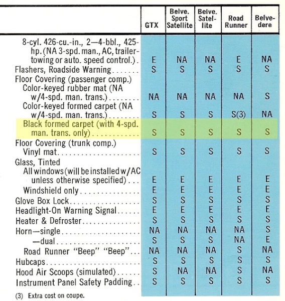

RM21 is a Road Runner Coupe. 4-speed Road Runners got black carpet, regardless of base or Decor Group, HT or Coupe, or interior color.
Auto cars with Decor got a dark, color-coded carpet.
Occasionally someone claims to have an exception, and it's possible, but all my original 4-speed RRs had black.
They've all been bench cars.

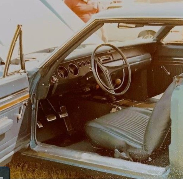

Although this is a '69 Dodge, B5 with B7 UDF, the carpet was medium blue. I know it's hard to see. Maybe this can help. Or not.
Thank You, I understand what the book is showing black but the original medium blue headliner is throwing me off too. Think I'll go with medium blue carpet too then.
