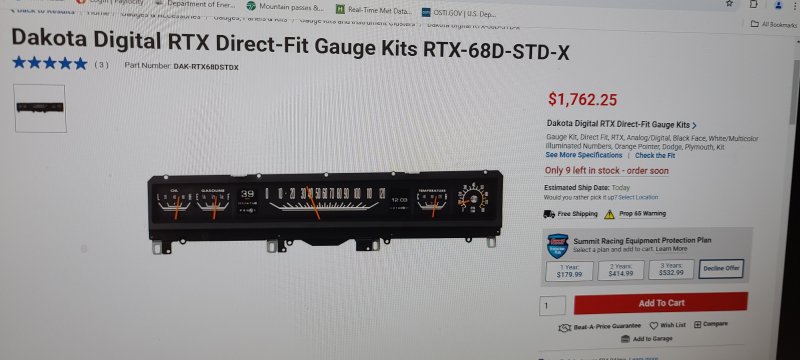

A pic of what? The malfunctioning integrated tachometer in this dash?
