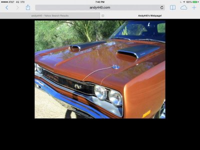

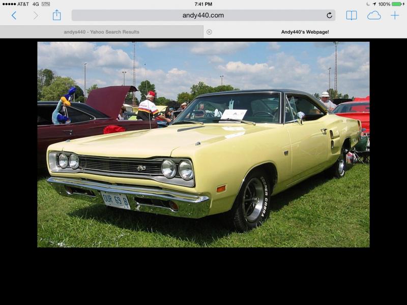

image.jpgimage.jpgAndy's 440 is a good website for reference shots. My grille is with 5.7 hemi member getting r&r'd with the correct argent for the headlight bezels.
