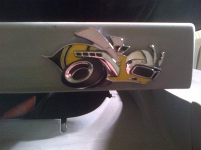

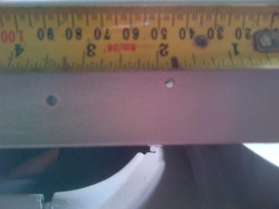

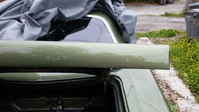

I clicked off a couple pics for ya. IMG-20140612-00257.jpgIMG-20140612-00258.jpgIMG-20140612-00259.jpgIMG-20140612-00260.jpgIMG-20140612-00261.jpgIMG-20140612-00262.jpg
Is that the factory location, chargin'? Because I've seen more than one located there.

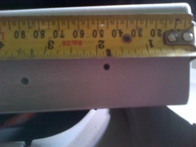

Here's the dimensions pic I have:
this puts the post at the head of the emblem right inside the rubber bumper mount of the deck lid. Not an easy spot to get fingers or tools to attach the post nut.

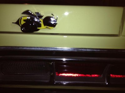

All I can tell you is the dimensions I gave you came from my Super Bee's deck lid that I have owned since 1973 and I still own it to this day. I also am pretty sure of its history prior to 1973 since I bought it from my Cousin. To the best of my knowledge, those dimensions are correct and from the factory. However, I was not at the factory when they were drilled.

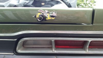

The car has been restored and here is what it looks like now.

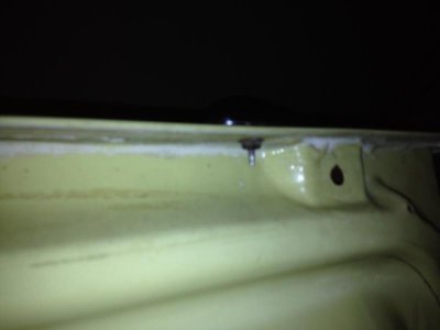

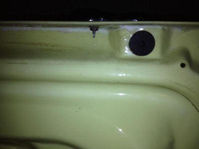

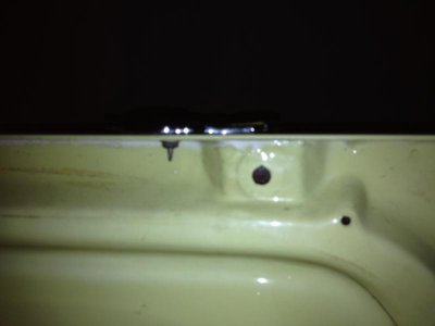

Don't know if these shots will help.the post on the head of the bee is almost perfectly in line with the hole for the rubber bumper.the post looks like it has a black plastic piece that is holding the post on

Thanks Bee383. I was thinking of using a push on clip rather than the self tapping nut sent with the emblem.
Would certainly make it easier to get on! I may even be able to push on the self tapper then give it a bit of a twist at the end?
