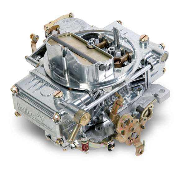

Could it some how be vapor locking even though Im seeing fuel spray in the carb.?
An older Holley set up single feed fuel line connects in from the drivers side
it must be an 1850 600 cfm. I have probably been through 6 or 8 trying to get a good one. they like to flood, they are finicky in my experience. I finally stopped using them, when they work , they work good. a couple would start and run , then start misfiring and flood out. I even bought one brand new and it leaked fuel from the throttle shaft
