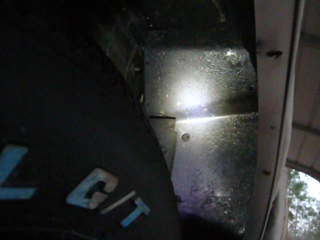

inside fender is this the splash shield Im missing and anything else? Need both if anyone has them,pic is towards upper firewall

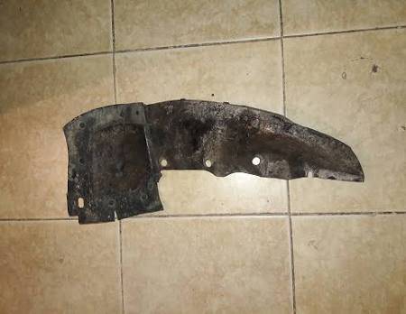

is this what Im looking for
?q=tbn:ANd9GcRIg7eXpg7FA6zeXiPa8p-PCQidXcynU2_68BQr6EMjOJk9FGGXbIYKgicywoJDGIqJohhvbTs7&usqp=CAE.jpg
We don't know what you are missing. Rear side is the large metal shield and it's associated rubbers. One rubber goes along the edge against the inner side of the fender and the other around the remainder of the perimeter to seal the back of the fender. The kit will also come with the clip on rubber for the frame rail at the 4 speed Z bracket frame ball location. The smaller shield you show, and not sure that's correct for '70 but looks about right, is the headlight water shield. It also has a rubber kit to go with it (which appears to be your "rubber" picture).
The headlight seals, post number three requires a two piece masticated rubber seal for each headlight seal. The rear splash shield for protecting the door hinge area takes the upper "C" shaped masticated rubber seals and a "T" shaped rubber seal for each one of those. Then you have the masticated rubber frame rail splash shields that goes be lower control arm and the small metal shields that go in front of the upper control arms. All of these pieces are available in a reproduction.

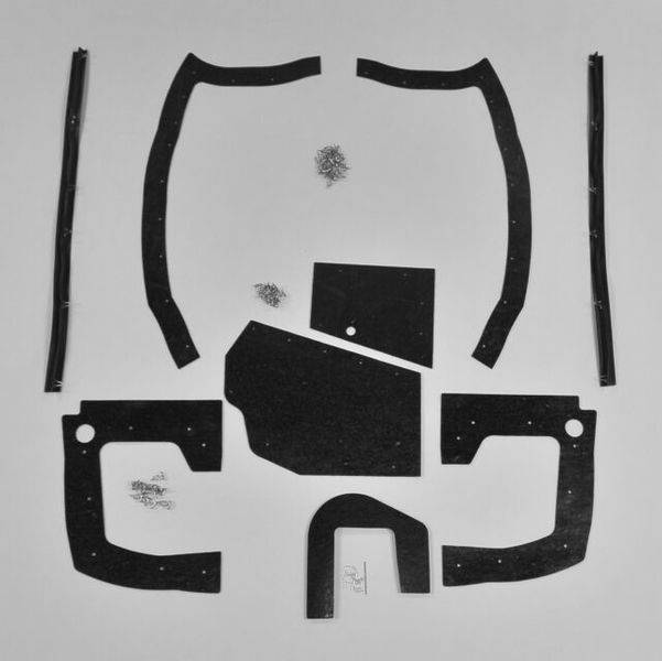

looking for pic of the shield that protects door hinge area,is this the kit?
That's the same kit I purchased for my '70 Coronet. If that's the one from DMT, it worked perfect with the stainless fasteners. Also, I may have the key buzzer you were looking for. PM me, I will look at my electrical shtuff box tomorrow. I went all aftermarket and ditched the switch, but I'm a pack rat.
