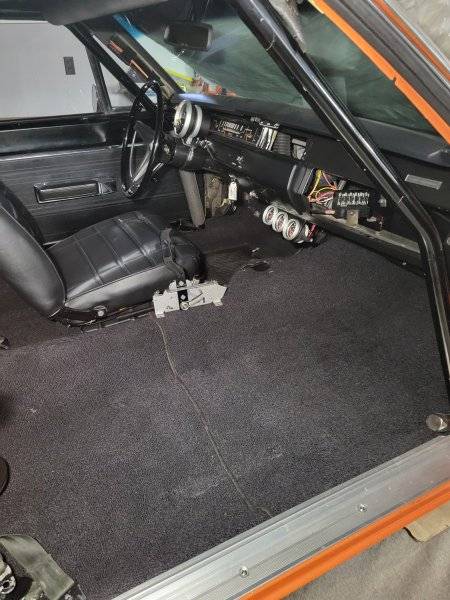

Just put a carpet in that the heel pad was not correct in relationship to original carpet. Wasn’t worth it in my mind to return it for another and didn’t want to lift the pad and resew it.

I just did my RR, '69. The rear is easy if it's molded. Don't worry about the front not overlapping. Get the vinyl pad about where you want it under or just back of the brake pedal. I had to cut a square hole for the accelerator pedal base,then, just square the front up. Cut carefully, don't hurry! With the slip of a sharp utility knife, almost cut the tip of a finger off. Got lucky, the cut will heal.
