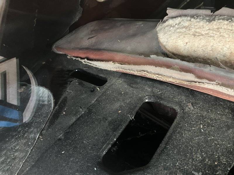

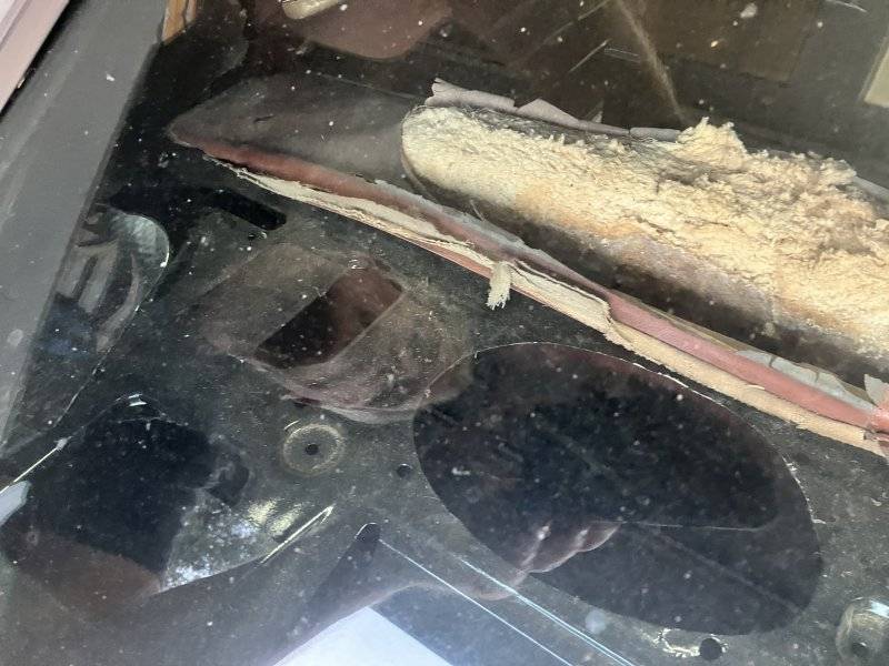

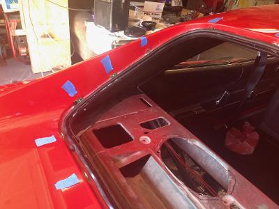

I read that rear shoulder belts were available in the 1968-70 B bodies but I don't recall ever seeing them. I'm assuming that like shoulder portion on the front belts, these did not retract? Looking at this picture from when I replaced the broken rear window after shattering it during a weed-eating chore....
The thin horizontal slot furthest to the edge looks like where the belt may have been attached?

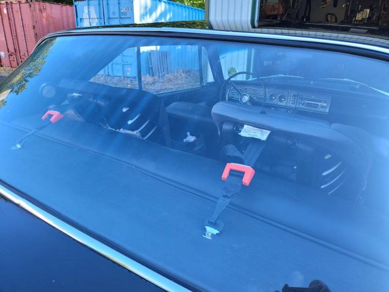

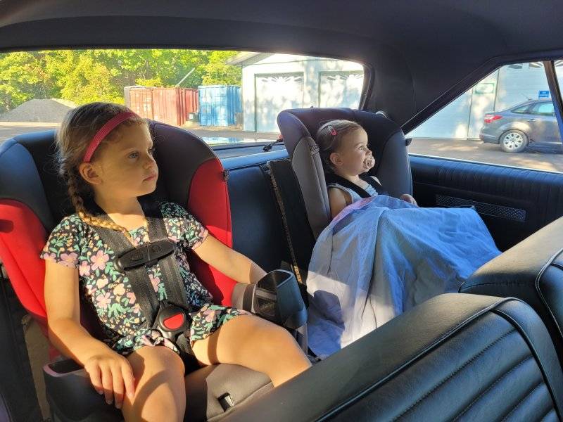

I added rear should belts to my 70 Road Runner back in 2015. Posts start here: Hawk-Rod: The Restoration
Here are a couple of (not great) pictures after installation: Hawk-Rod: The Restoration
I've had these (and passengers have used them) for 10 years now. They work great (at least to take on and off) and no complaints from back seat passengers. I've never tested them in a crash and don't intend to try... :poke:

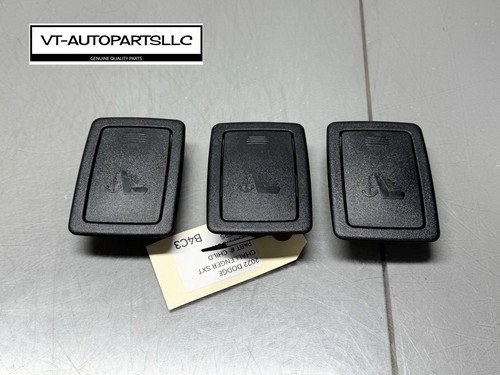

My vision of the restraints is exactly how Wayne installed his. Mopar sells the U-shaped bracket, and I purchased on Ebay a three pack of the plastic flip-up covers that are installed in the late model Challengers.
Talking to @HawkRod, he purchased front shoulder belts from Seat Belt Planet and modified them for the back seat, and naturally they came out looking like an OEM install. Greg and I, being the cheap bastards that we are, are planning on a Pick n Pull recon mission to find some used rear seat belts out of a late model sedan.

Thanks Wayne, your resto posts illustrate how I want to update the Coronet. I plan on using the flip top bezels from the late model Challenger, so I'll have to fab a box for the bracket and weld it to the underside of the package tray.

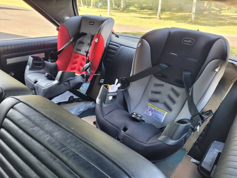

You have darling granddaughters BTW. Mine are a little older; 7 and 5 years old; and they love driving in the Coronet. I chauffeur them to and from school on Tuesdays but I'm not taking the Coronet until I have the upper restraint tabs installed. I don't want a teacher or a nosy mom pointing out the obvious.
To each their own of course, but I ran the Simpson forward facing car seat with just the center lap belt in both my cars and was able to sinch it down very tight and secure. I wouldn't ever tell someone to not use the LATCH mechanisms but just pointing that out. I also had a 99 intrepid when my daughter was young and it did not have LATCH at all so I could only use the lap belt.
For sure, my generation and my kid's generation all grew up without the LATCH system and lived to tell about it.
I currently drive the girls in their car seats with only the lap belts securing them in. It's not the most secure way, and my son and daughter-in-law trust me enough take them around town. But everyone will feel more at ease with the upper latch installed. And I'm going to enjoy starting a new and out-of-the ordinary project.
The old Dodgecharger.com site had a big topic about this with pics. Yes, the slot in your pic is where they go, Greg. There's been one or two cars found with them at most, super rare option.

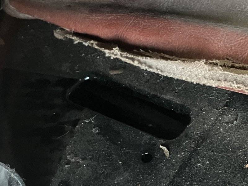

Here is the left corner of the package tray of my Jigsaw Charger.
The slot measures 3/4” X 2 3/4”.
I have a 72 Duster out back that has similar slotted openings in about the same place. I have owned close to 30 A body cars and have never had one with rear shoulder belts. Just like the B bodies, I don’t recall ever seeing one at a car show either. I know that automakers get some advance warning about Federal regulations that are coming so I wonder if they stamped these panels figuring that they would be ready in case the shoulder belts got mandated with Ralph Nader running amok.

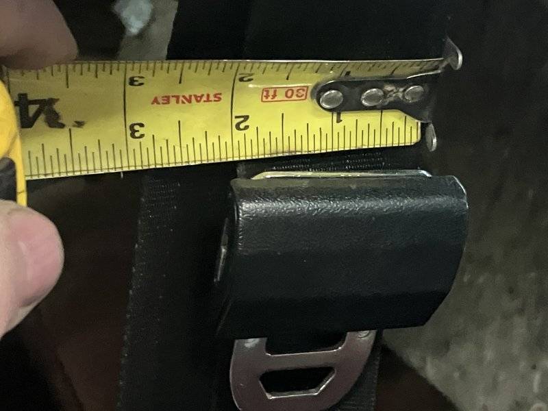

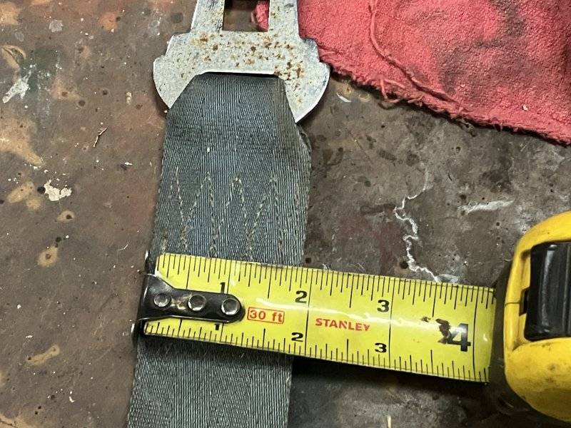

The belts themselves are 1 7/8”
The aftermarket belts in the car also measure 1 7/8”.
