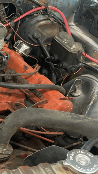

I’ve seen some older post for this, does anybody know where I can buy an engine side brake line master cylinder? I have one that leaks. I’m a new Mopar guy. Just bought this Charger and am restoring it, but it doesn’t have to be original. Thankyou.

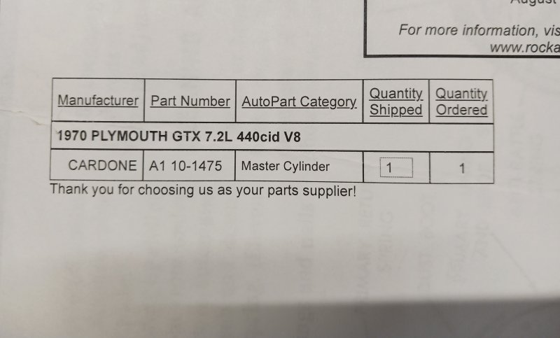

Have it rebuilt with stainless sleeve. Note how expensive they are see^^^. On ebay $300 fur a used needing rebuild.

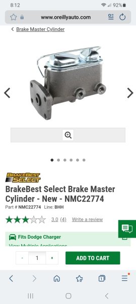

I was able to get one from my local auto parts store. They kept bringing me one from the back with driver side brake lines outlets for a 70 Charger. However, when I mentioned with cruise control they were able to bring me out a different part # that had the passenger side outlets. Or, ask for one for a loaded 70 C Body. Same part #.

why you didn't post the part number
