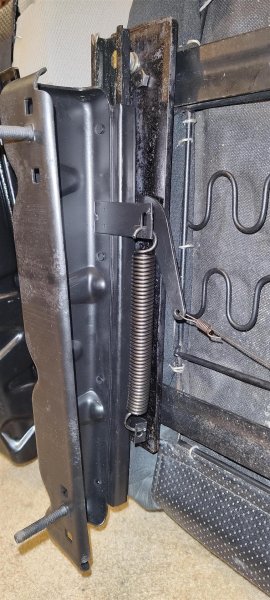

I had the seat frames out of my car for restoration and upon reassembly, I noticed only the driver side frame had this thick beefy spring, in addition to the small yellow outer spring for the adjuster lever, and the cable that joins the adjuster levers on both halves. However, the passenger side frame is lacking this big spring. It otherwise works fine after reassembly, the adjuster lever and cable releases the adjusters and the seat will slide forward/back. It just seemed odd because it appears the passenger side frame has mounting spots for this big inside spring. Do the passenger side buckets not have this spring?

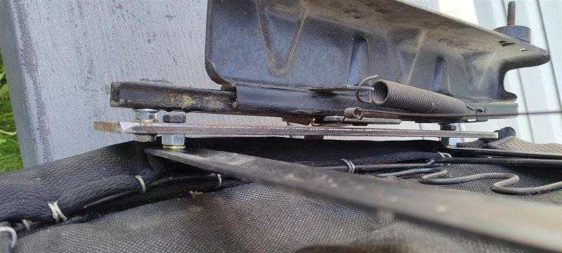

Thanks for the offer but I don't need one - I was just saying that if not installed properly it can fall off. Mine did then I put it on correctly !

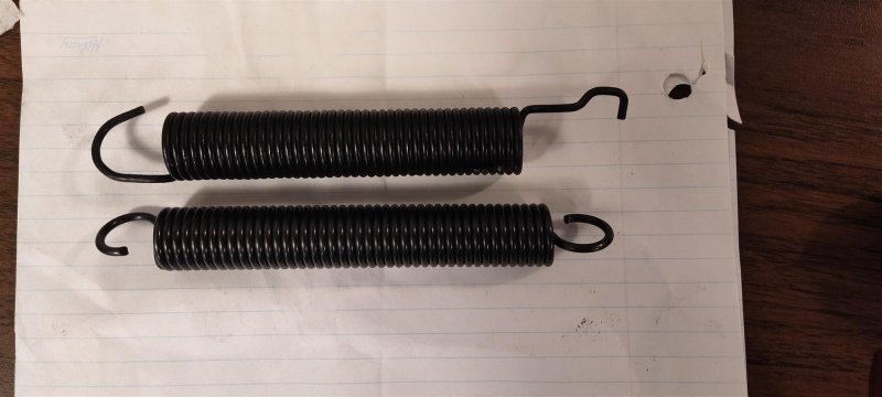

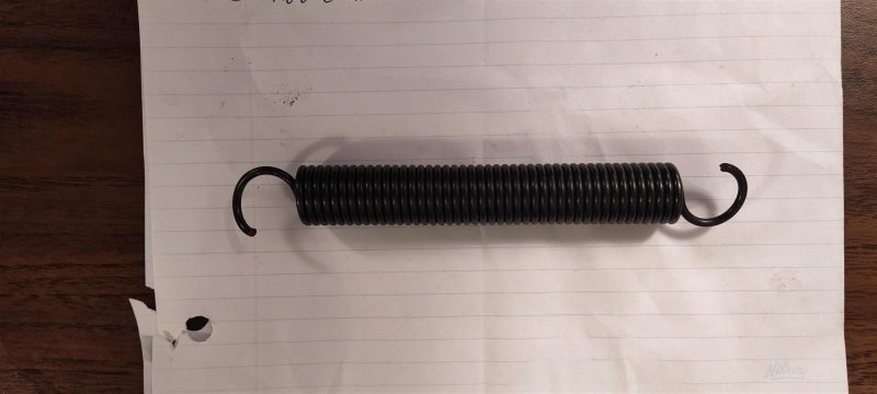

Well, the Amazon spring worked! Here's a comparison of the original spring and spring I got on Amazon; the top one is original:
Amazon spring
The spring I got on Amazon has slightly thicker wires and maybe 1/3" shorter. As expected with the slightly heavier wires, it was a bit stiffer than the stock spring. I slightly unbent the overly-curved hook ends to make them easier to snap into the holes, holding the main spring in a vise and needle-nose Vise-Grips for the win.
And voila; I installed the original spring on the driver seat:

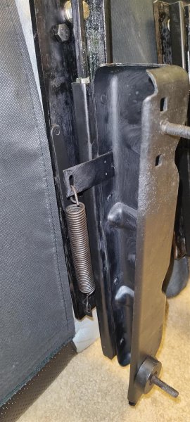

And the Amazon spring installed on the passenger seat:
