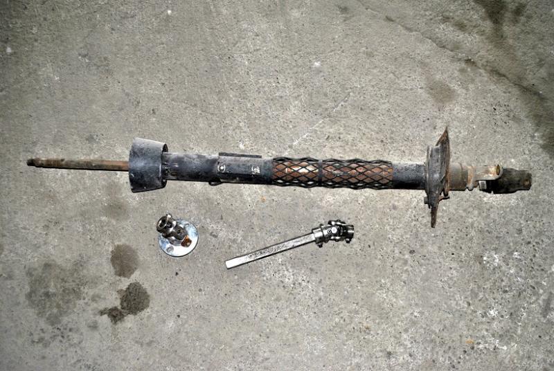

as the steering column I got with the car is pretty beat-up I'm looking into possible replacements. Any suggestions? Floor shift... I'd like to keep ignition switch in the column even though wiring I got for the car came with dash ignition switch.
thanks,
How bad is the column, I have some column shift parts in a bucket, I mean if you just need to rebuild your column the cost is not high, paint, sand paper, a couple switches, bearings, $200 should do about any column no matter how bad it is... you got pics?
It was a column shift - now the shifter is in the floor. I am looking to buy a used column to rebuild it - perhaps I can put one good one together out of two with some new parts that are still available. Steering has been converted to rack and pinion. Was wondering if there is a unit out there, like Flaming River that I can just use.
Well if you dont care about being original I would buy a tilt key floor shift aluminum column off of ebay for $200, BUT that is a lot of work to install, best bet is to take that column apart and just buy what you need, I can send you some pics from the service manual that shows the exploded view, they are pretty east to rebuild and the parts are cheap.

thanks, I actually have two column shift columns and am considering a rebuilt. I don't care for originality since the whole car had been upgraded with bells and whistles. I got it already painted, rolling with a rebuilt and upgraded 440. Will give it a try - I have never really thought of any cheap alternatives - just thought that unit from Flaming River that runs for about $800 at Classic Industries is something worth the money.
