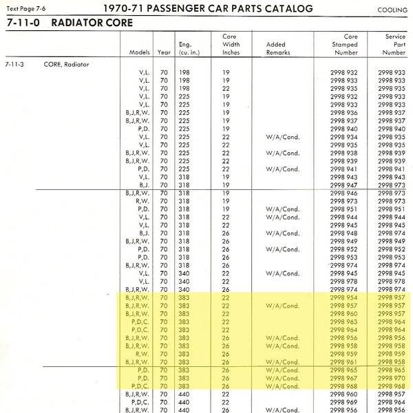

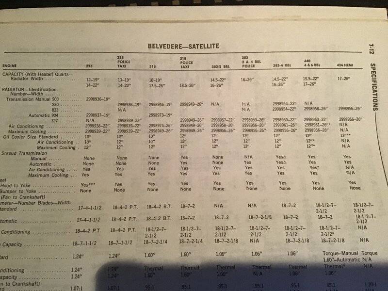

Here's what the parts book says
So apparently there was a 22" option... 2998957 Never seen that....

If you look in a 1970 service manual it is all spelled out on what combo had what rad number
1970 Plymouth service manual page 7-12
