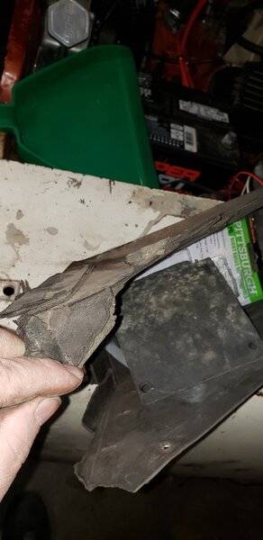

Not sure how Don got his out the front without ruining it, but I have never been able to do it. One of the few flaws on these old jalopies imo. You would have thought Chrysler could have designed one that was easily replaceable, especially since it is just made out of card stock.
I read benbuilder's post #7...take the front seat out?? Guys, are we talking about the same thing? The glove box on the front right side of the passenger side, right? My paperboard glove box was worn out so I took the glove box door off by removing the screws holding it, then removed the screws holding the old glove box, ripped the old one out, and then carefully inserted a new one. Ah ha, maybe that's the deal! benbuilder is trying to salvage the glove box he has and can't get it out without destroying it. In that case, good luck. He may be better off doing what I did. Either way, I was still able to insert the new one without any big problem, and I'm certainly no genius when it comes to these old cars.
Yeah, I spent 30 minutes trying to delicately remove mine before saying "f it" and just ripped it out. I have like 3 card stock replacements in my attic, they aren't expensive.

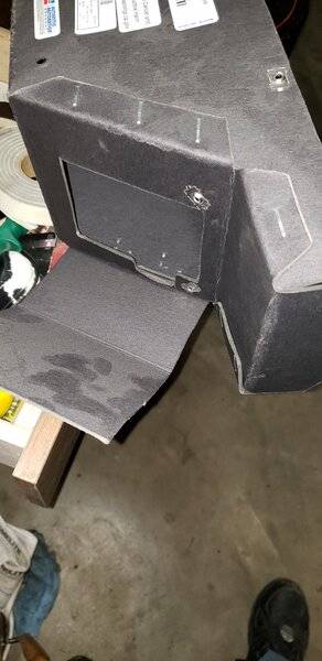

Whats with this flap on the back? Is that for Rallye dashes? I have a standard dash. I don't see how the flap can stay on with installing the cardboard box.
Am I missing something?

Whats with this flap on the back? Is that for Rallye dashes? I have a standard dash. I don't see how the flap can stay on with installing the cardboard box. View attachment 1021297 Am I missing something?
Mine didn’t have the flap so sorry no answer for you.
I figured it out. The flap is supposed to be on the top. So I pulled the staples and put it on the top.
