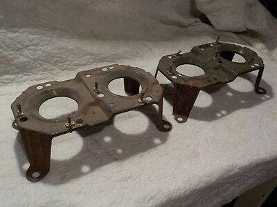

Hello all.... I'm trying to put the headlight parts back in this 70 coronet that I didn't take a part.... they could fit either side and one half is taller than the other half so one side is going to stick out further....can someone shed some light on which way these go ??? this is a picture of the same ones I have from ebay just so you can see them...…. Thank you in advance for any input

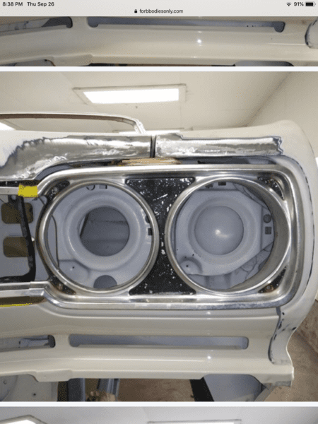

The shorter side of each would be the inboard light. the 2 closest to the center of the grill. You can see in this picture they are inset more into the bezel.
