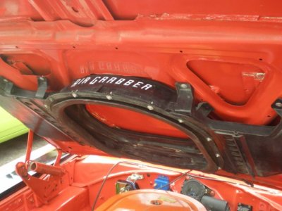

hi, can any one out there get me a pic of how the under hood pieces for a 1970 dodge coronet ramcharger hood are assembled on the hood, a pic of the cables, where it goes thru the fire wall, were is the control mounted on the inside of the car, etc.. and is there a good place to get replacement cables for it? thanks for any help

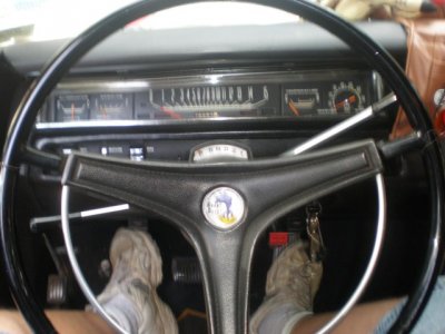

cable handle mounted under dash
mounts just to the right of the column , just ignore my pretty feet LOL

thank you, is there any way to get a pic of the cables mounted on the back side of ramcharger pieces?
is there only one cable that connects the two vents? and then where does the control cable conect to?
