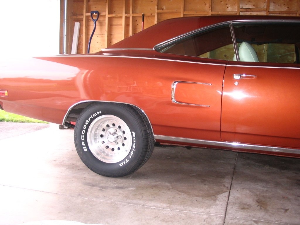

I have a 1970 Plymouth Sport Satellite. The biggest tire I can get on the back of my car is a 275/60/15 and they are almost touching the fender lip. You could always trim the fender lip a bit to fit a larger tire. I have 235 on the front. I've herd talk that Dodge B Bodys could fit a larger tire then a Plymouth B body car.
i.am running 275/60 on rear and 235/70 on the front rim's 15x8 rear 15x7 on front
Generally, 235/60-15 front on 7" & 275/60-15 rear on 8" are optimum. You "can" do wider, but it really depends on backset.
8x15 front with 245/60 and 15x10 rear with 295/50 on a 70 RR. no problems.

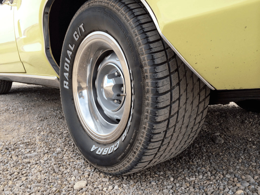

It's hard to find wide redlines. I have some 17" magnums w redlines from Coker they look wonderful but aren't the widest tire maybe 9" at most. But 68-70. Plymouth/Dodge b-bodies look gorgeous w redlines. I say don't be afraid to go for it. They are a bit pricey though.
