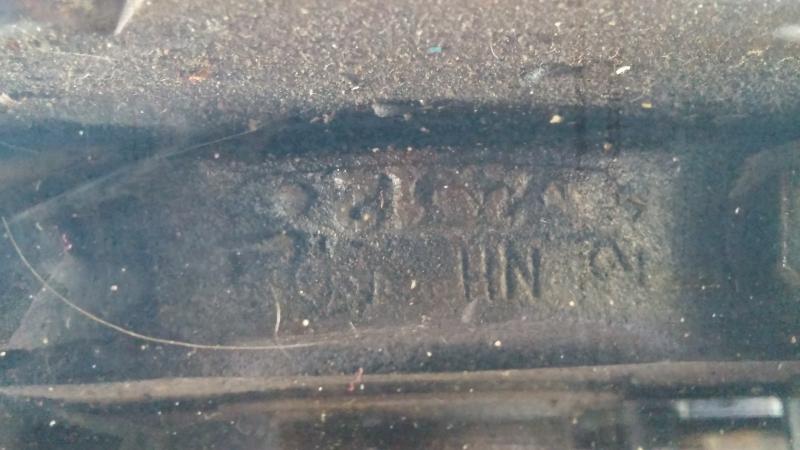

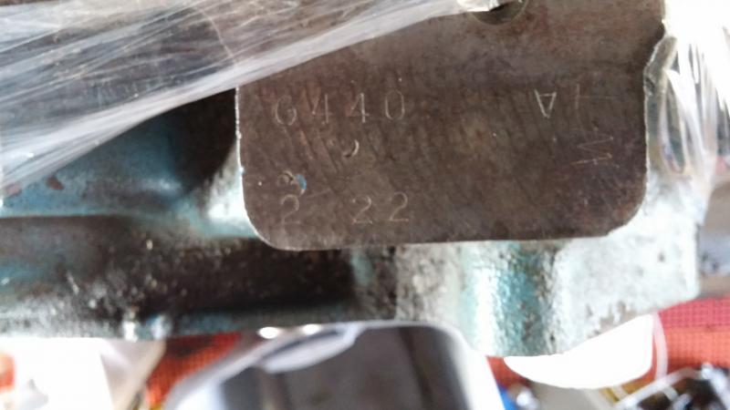

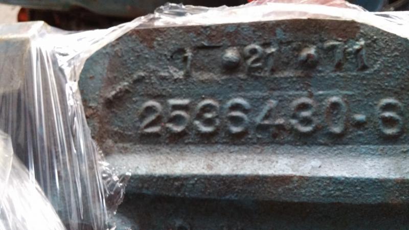

Casting dates can go way back. I have Jan 70' casting date in a Aug 7' 1971 440(1972 model year)As well as a 1974 HP 440 block with a 1971 casting date.
