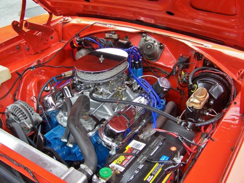

Are you looking for a m/c ???
Chuck

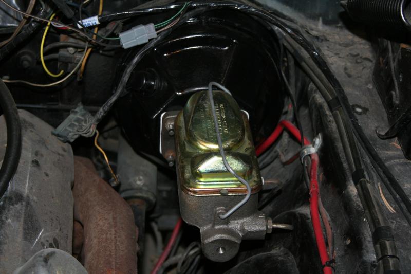

Mines a 440 with power disc. If needed I can send pics after 7pm tonite.
Chuck
Here's mine.
Not mine, with a 318.

That would be great. I always like to see original stuff, makes it easier to compare the repop parts. thx
disc/drum
I have also seen master cylinder listed with brake lines coming out on either left or right side......
disc/drum
Some cars that had the brake lines engine side were recalled for making the fluid too hot. They were changed to fender side.
