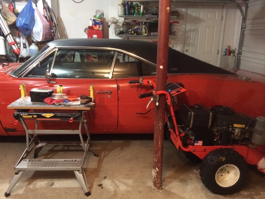

The Thanks everyone! I did put some stripper on the firewall but all the photo I have seen that's a Challenger spot. Here she is!
